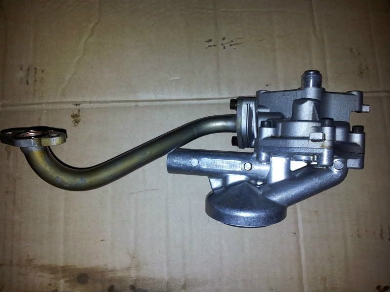

you do need an r32 oil pump mate, the standard vr one is to long and you wont be able to fit the sump for that reason. here is a pic of the pump that i had fitted when i had my r32 sump fitted, you can see what i'm on about.

Is that the case Karl? I thought these were the 2.8 24v sumps that aren't as shallow as the R32 ones. So wouldn't need to have the R pump as well?
The 2.8 24v sump woks just fine with the vr6 pump. It's not shallower but the bottom profile seems flatter. Has a larger capacity about 1/2 litre. And I now seem to be running slightly cooler.
I would recommend longer bolts as the alloy is much thicker than the old steel sump. And, if changing the bolts, you can use the old style rubber gasket.
I found the original gb and it seems that the std vr pump will fit. Science, where did you source the new bolts mate? Oem 24v bolts?
Cheers guys
Just to clear up some confusion. 2.8 24V is essentially just an ally version of the steel 12V sump. It's not baffled. It just has 3 cast-in vanes to help direct oil to the pump pickup.
3.2 24V is both a lot shallower and baffled (plastic inserts which stop the oil flowing away from the pump head). And because the 3.2 is shallower, the pump pick up had to be redesigned, as Karl said. The actual pumpy bit is the same on all the V engines. VW won't sell you just the pick up though! Gits.

This is an R32 sump and pump. Even the output tube is different! Where it bolts to the block it has an O ring. 12V and 24V doesn't.
