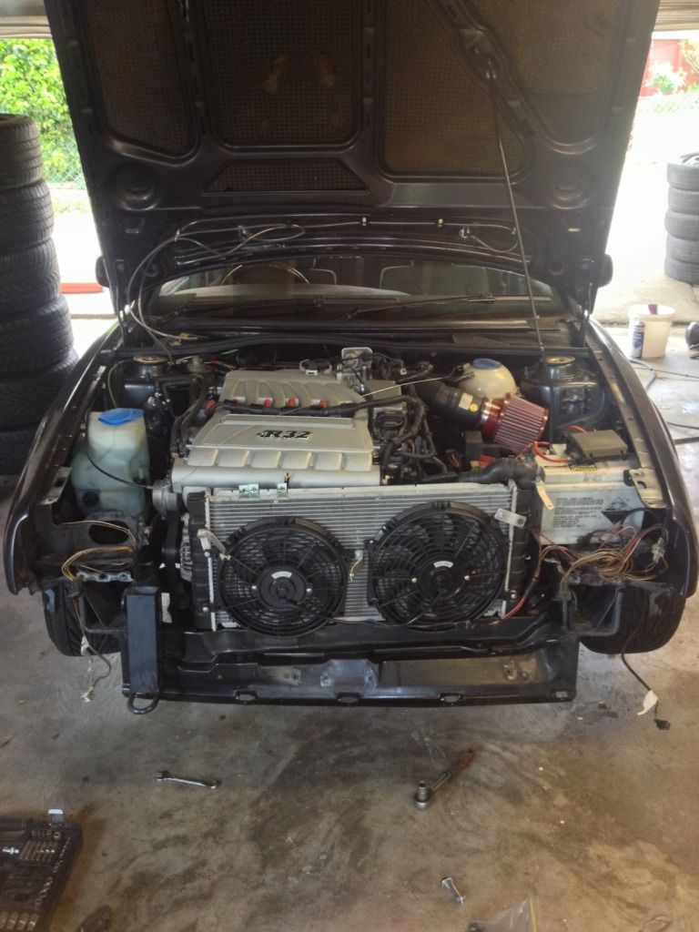

VW_OwneR_85 2 Posted October 2, 2012 looks good with no hood ;) whats the difference in performance now with the 3.2 ? Quote Share this post Link to post Share on other sites
VeeDub_NZ 0 Posted October 2, 2012 Well I only managed to drive it for about 3 or 4 min at moderate revs, i didn't want to push it too hard initially. It should be around 50 - 60hp more than the BDE 2.8L motor it had in it and it definitely feels that way. It's impressive, quite rapid - i'm very happy & blown away, I wasn't expecting such an increase in torque & drive-able power. The 3.2 is a weapon compared to the 2.8. After a test run I took it home & fitted bonnet, lights, grille, lip etc. By then the car was cold and it was about 9pm, I took it for one last test run before an event I had organised for the next day. Managed to drive about 400m cold at low revs ( Tomorrow i'll drop the sump and measure the clearance. Order a new 12v oil pump (am using the R one at the moment) and will grease the gears on that. Hook up a pressure guage and crank it over with the plugs out & cross my fingers it goes. If it goes bad, the motor will be coming out again. No idea what's caused it but the last motor died because the sump smashed the oil pick up to pieces when it collected the road. That hasn't happened this time, sump hasn't touched the ground at all so i'm a little worried. The motor has run for at least 30 mins since the swap though so whatever it is has happened since then, the motor didn't come with something wrong. Quote Share this post Link to post Share on other sites

VeeDub_NZ 0 Posted October 20, 2012 After a few weeks of being super busy at work I finally got time to look at the Corrado. Dropped the sump and found this. Sad sight, but onwards and upwards. Motor is coming out again and we'll pull it apart and find out what's happened. I'll shorten the steel sump at the same time and retain the R32 pick up for some extra clearance. Exactly how much clearance does the pick up need to the sump?? Quote Share this post Link to post Share on other sites
