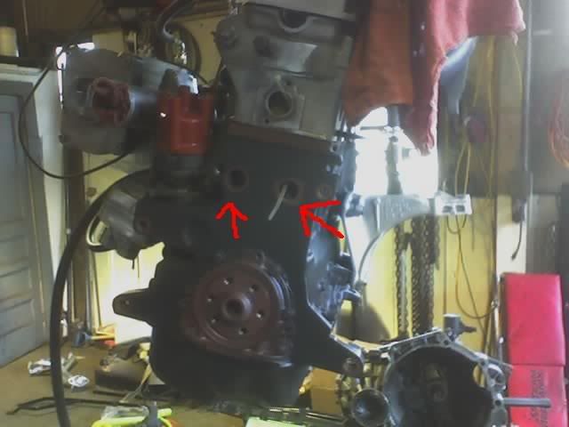

there are some freeze plugs on that end of the block here is an image
http://i101.photobucket.com/albums/m77/vdubpimpx/noname.jpg
Ah that looks like it could be the culprit.
is it like the core plugs on back of engine?
i cant seem to see any of these holes or plugs on etka or bentley manual?
dont suppose any one know what they are called or even a part number?
Thanks for the photo

i have just spoken to vw about replacement core plugs.
they can see a few different size ones but cant tell me which ones i need for flywheel side of block as in link above
i havnt got the flywheel off yet so cant measure.
can any one tell me which size they would be or even better a part no???

Don't understand the VW stance. There are 4 core plugs at 36.6mm and one at 14mm. The 14mm is at the cambelt end along with one 36.6mm. At the gearbox end there are 3 core plugs used at 36.6mm. So two 036 103 113A is what you need for in behind the Flywheel. This has superceded the original 36.6mmm spare core plug 059 103 113. Or as below use the older part (same 36.6mm).
This is the original spare...... 059 103 113.
http://www.ebay.co.uk/itm/36-6mm-Crankcase-Freeze-Frost-Plug-cylinder-block-059103113-VW-AUDI-universal-/170794859699.
Or http://www.volksbits.co.uk/servlet/the-11651/36.6mm-Crankcase-Freeze--fdsh-/Detail
Its a standard core plug VW use in all their engines.

thanks for the info.vw never seem to be that helpful!
flywheel now off !
what i cant under stand now is i have 4 core plugs under the flywheel on side of block?
-the two with the arrows in link above i measured at 24mm?
-one 14mm
-one 36mm
hopefully i can get right ones now with this info
