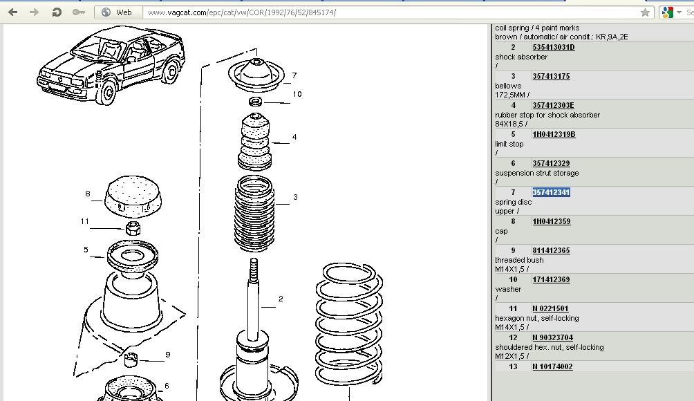

Finally realised why i am having issues with my coilovers.
The setup never had a set of top spring plates on them
its the one labeled 7 in the pic.
I believe 16v's and 8v's share the same part
