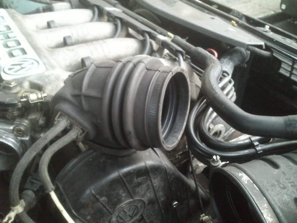

Right here we go! :dance:

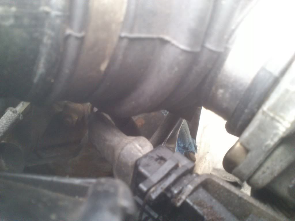

Actually my chav blue silicon pipes make it easier to see, the one that goes from here

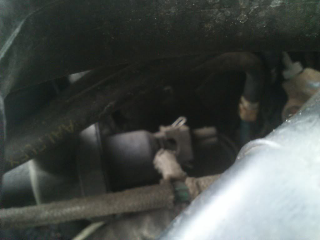

Goes to here.
You can see two of em on the left, and one on the right. The one your looking at is on the right, although the two that are on the left, go to a 2-1 splitter and it also goes into the same place slightly behind where the one your after is located.

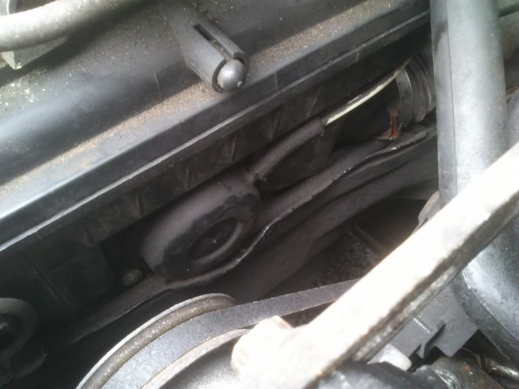

If you trace the one from here.
through the splitter you will see where it will go. It will probably be easier to remove the intake pipe to put it back on. Hope this kinda makes sense mate! :thumbleft:

Right , its sorted, picture of the places where they both go to, just in case anyone else has this issue. I still dont know what they both do , unless its to open the hot air pipe thingy in the airbox
The two rubber pipes in the photo connect to the thermostatic control valve which senses air intake temp.
One pipe goes the engine side of the airbox to control air intake mix of cold air and hot air which is derived of the outside of the exhaust manifold (check it is intact and not dragging in cold air through a breakage).
The other pipe goes the fuel over-run cut off valve and a pressure diaphragm (disc unit). The pressure diaphragm controls the 5th injector (blue connection unit on the inet manifold) so that fuel is injected when the engine starts or when accelerating during the warm-up phase. It gets switched off when the coolant therm-switch senses a warm engine. The thermo-switch is located below the top radiator hose coupling coming off the front of the engine.
So if this lot doesn't work, you starting will be a long cranking of the engine rather than instant and you will have flat spots during the first 5minutes of warm-up of the engine.
