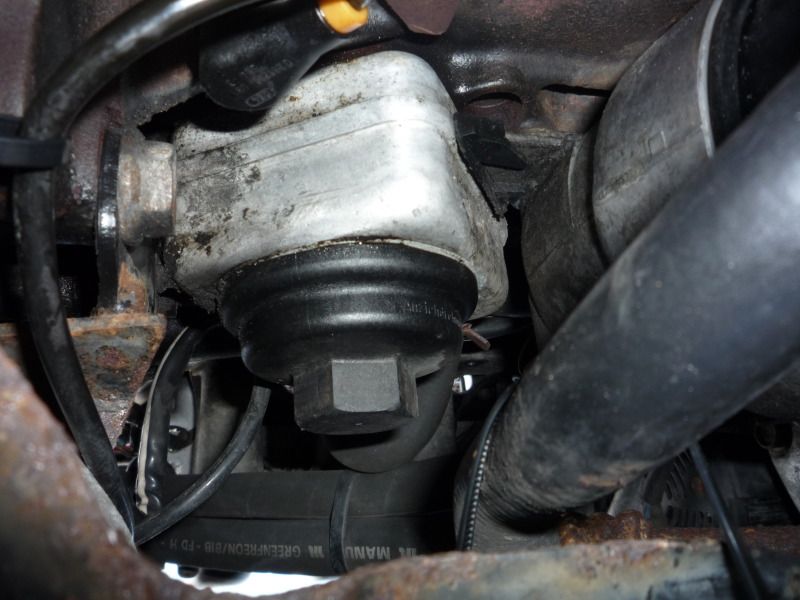

Well i got pics and also i got seals from VW today at the cost of £4.73 for 2 seals.
Here is a pic of the plastic nut holding the Oil cooler in place
I measured it and it is a 32mm.
So is this from a 2.8 24v ?
If so is it different seals i need and why would it be fitted?
I did this last week and that is not the standard cooler securing cap. See VR owner's third pic. BTW I ended up breaking off the attachment to the crack pipe, so ended up removing the whole front end to do the job properly.

So i wonder if its been replaced in the past?
Its an ABV code.
