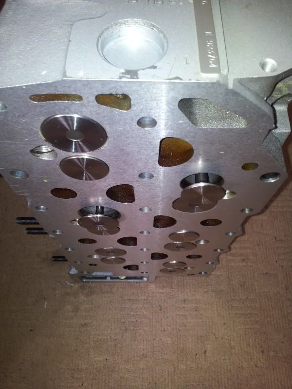

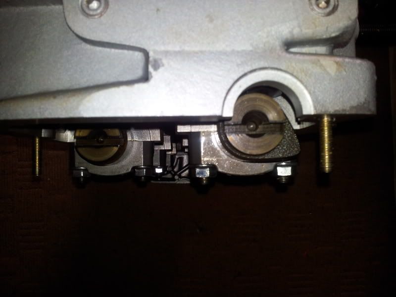

Anyway i have a few questions just to rest my mind before i do the job, seeing i dont have the standard crank pulley on i have no way of finding TDC that way, so after i take the head off is it as simple as just turning the crank till cylinder one is at the top and thats TDC??
And does the head look like its all set up for TDC??

Karl, it's straight forward as long as you have the tool (plate) to lock the camshafts in place. Also, if your pulley does not have a timing TDC mark then you need to mark it by using a dial gauge to get piston 1 at true TDC. I did say a while ago that I had a dial gauge you could borrow but you didn't reply.
