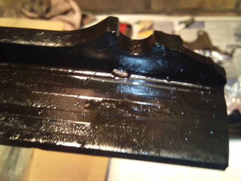

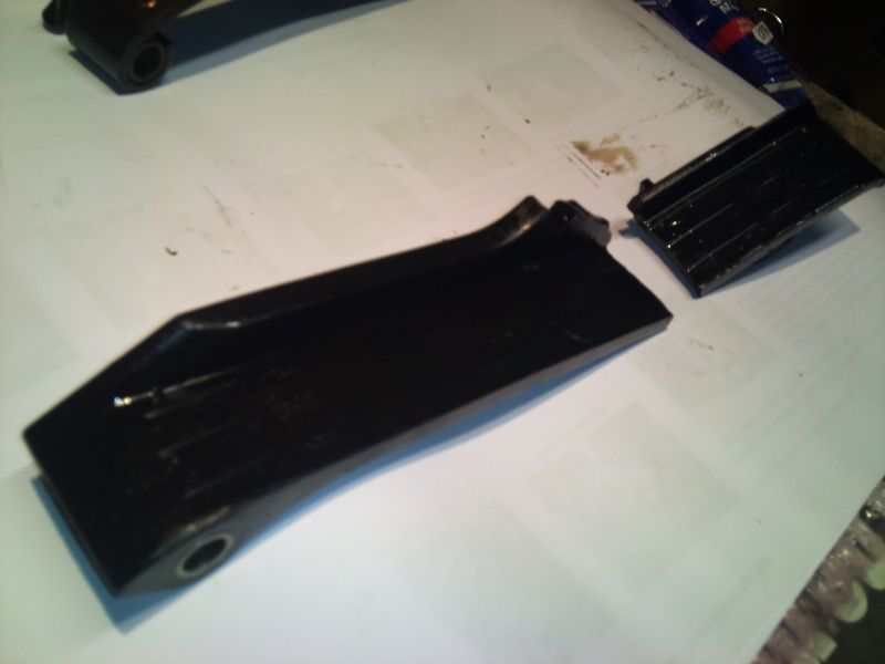

This guide was broken in two before removal
Should be a bit here on top of the screw hole, was missing altogether and no where to be seen

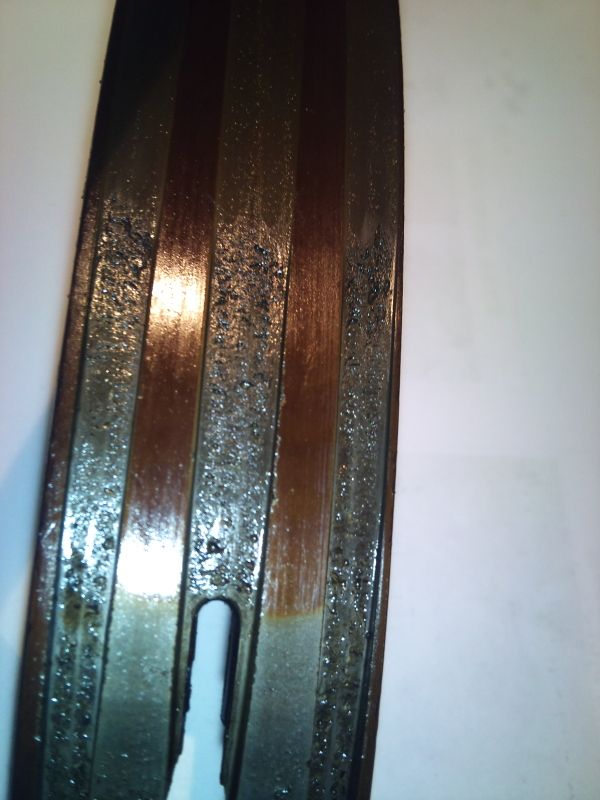

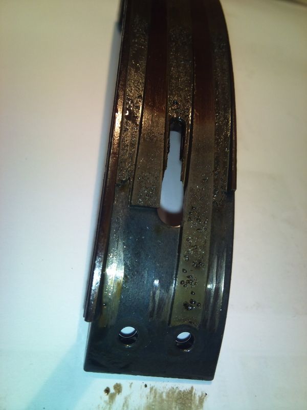

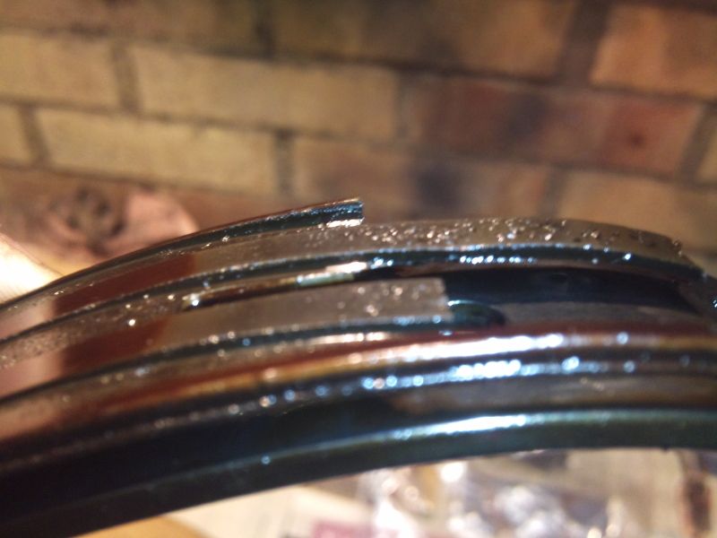

Upper Tensioner pretty worn..
