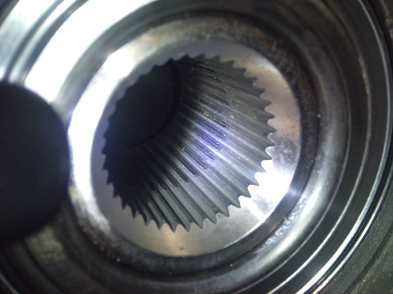

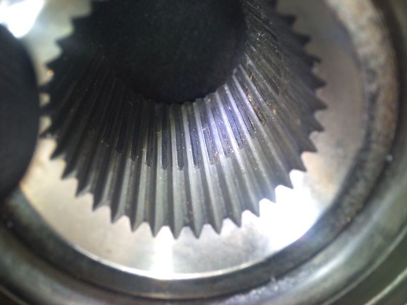

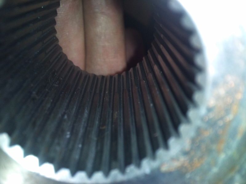

Jim Bowen 1 Posted August 15, 2012 (edited) Really a bit angry at the moment, gone to fit my driveshaft to my brand new hub and it wouldn't fit, did the other side and it just slid on easily. Thought i'd recheck the new one and noticed the splines seem flattened off inside, which is the exact point the cv joint stops going in. Am i meant to force it through? can't see that being right and refuse to hit it with a hammer incase i damage the hub. Tried to photo it. What i really need to know asap is: A) is it meant to be like that? unlikely imo B) Could it of been done by the garage who pressed bearings in? C) Could it of been like that new from VW? Going to go back to garage who fitted them and see what they say, then i will go to VW garage. Thing is, its a brand new bearing as well, so that needs to be destroyed to remove iirc Can see this all coming out of my pocket tbh ---------- Post added at 7:25 PM ---------- Previous post was at 7:23 PM ---------- I 100% haven't done it as its from the wheel side, i.e: CV spline goes in ok, then stops at the point the splines change. I don't really know how they press in the bearings and if there's any risk of them damaging it like that during the process Edited January 31, 2013 by Jim Bowen Fixing broken photo links Quote Share this post Link to post Share on other sites
lewvw 10 Posted August 15, 2012 Is there any sign of anything being forced in there? Or hammered out? If not it may be a machining issue? The hub would press in from that side but it would take some force to flatten the splines I imagine. Quote Share this post Link to post Share on other sites
Jim Bowen 1 Posted August 16, 2012 No there isn't any marks on it at all. Am starting to think it came like this from VW, i think if the garage did it, it must of been pretty hard to get something into the hole and back out again without marking it elsewhere. Am driving over to VW at lunch time to see what they say, i hope they take it off me and fit all new bits and give it back free of charge, but its a big hope :lol: Quote Share this post Link to post Share on other sites

Jim Bowen 1 Posted August 16, 2012 (edited) Just got back from VW, was 3 of them looking at it and came to the conculsion its whoever pressed the bearing in that has done it :( They have used the wrong press. Vw took the whole hub assembly off me and are going to see what they can do with it, waiting for their call. Which is good of them. I was all prepared to just fork out and buy a new bearing and hub, i asked 3 times to order one but they talked me out of it :lol: Edited September 22, 2017 by Jim Bowen Quote Share this post Link to post Share on other sites
Jim Bowen 1 Posted August 20, 2012 Still not got this sorted VW are now saying its meant to be like that, and to whack it on with a hammer? Chap said he looked at after one and it was the same Quote Share this post Link to post Share on other sites

VWVW 1 Posted August 20, 2012 (edited) I just went to have a look at a second hand pair of vr6 spare hub I have in the garage the ridges look uniform all the way through for both of them. Cant the VW dealership order another one just to show you if its suppose to be like that so that you can see it with your own eyes or pop over to a TPS near you and ask for a second opinion. TPS may even have one in stock for you to compare ? Edited August 20, 2012 by VWVW Quote Share this post Link to post Share on other sites
Jim Bowen 1 Posted August 20, 2012 When I went back they had got another one there, bnib and was exactly the same. My old ones aren't like it, but the workshop guy reckons they come like that. Can see me hammering the old cv in with everything off the car, and it getting stuck in there. So confused about it all, but can only try what vw said to do. Sent from my X10i using Tapatalk 2 Quote Share this post Link to post Share on other sites

Jim Bowen 1 Posted August 21, 2012 Nah, driveshaft (Outer cv) is fine, i just got a new one each side from VW and they have the same problem, its 100% the hub. Quote Share this post Link to post Share on other sites
Jim Bowen 1 Posted August 21, 2012 Tried hammering it on, and its pushed the hub out the bearing a little bit, so now hub is wobbly. Back to vw again tomorrow. Really confused with this, looked at the old original one and quite sure I can see similar marks. Wonder if they press them together then seperate them to fit bearings? Sent from my X10i using Tapatalk 2 Quote Share this post Link to post Share on other sites

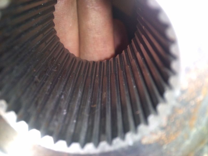

Jim Bowen 1 Posted August 22, 2012 Well been to two indepedant garages and also spoke to VW headquarters about it. Seems no one really knows why its like this and why the other side isn't. Also found out the old hub that i struggled to get off is the same inside and thats the original 17yr old one. It has the flat splines part way in and now it all makes sense why my front wheel used to get stuck on hub, which started after a wheel bearing change, looks like its been hit with a hammer, so this problem has obviously happened in the past. All i can do now is locate it the little bit it goes on then try and pull it through with hubnut. Stopped caring about it being easy to get off, i'll worry about that in the future. Will be interesting to see if this ever crops up in the future on here? I hope someone else has the same problem, not me being mean, but i feel unlucky and baffled. Quote Share this post Link to post Share on other sites

Jim Bowen 1 Posted August 22, 2012 Its doing my head in now. Just got the old cv and old hub (no bearing) and tried fitting them back together and i had to really smack the crap out of it with a big hammer to get it in and it still didn't go all the way in. Can only try fitting the new stuff and tightening it all up with the hub nut and hope that pulls it through, but i went mental with the hammer and can't see my with a socket creating enough force. Quote Share this post Link to post Share on other sites

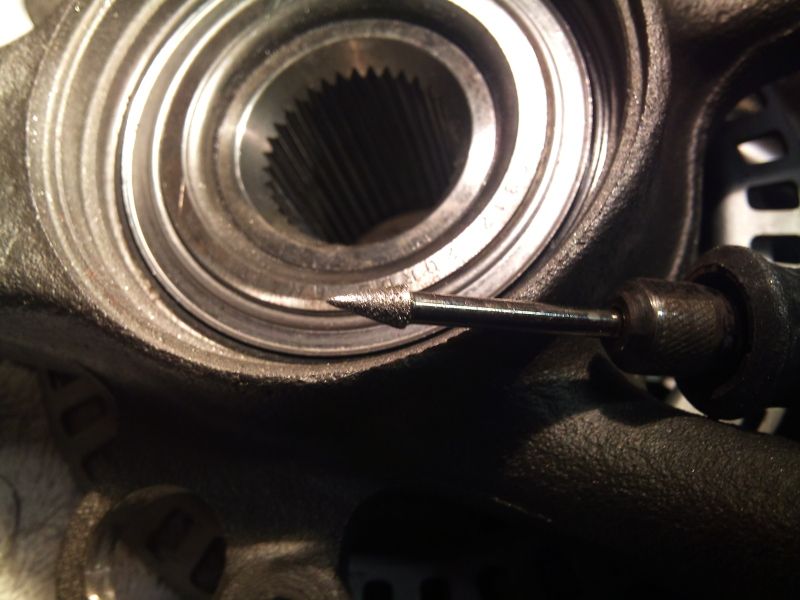

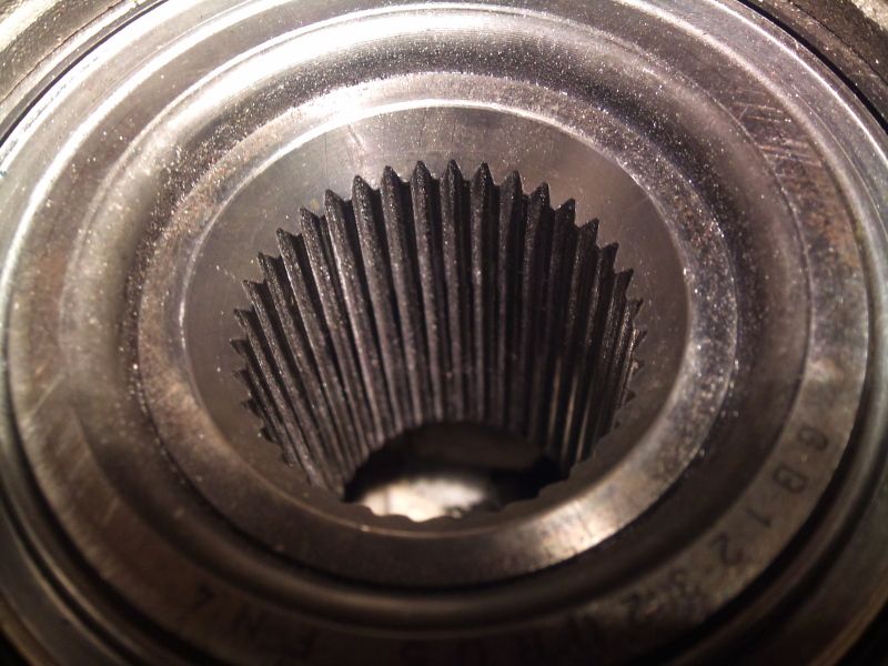

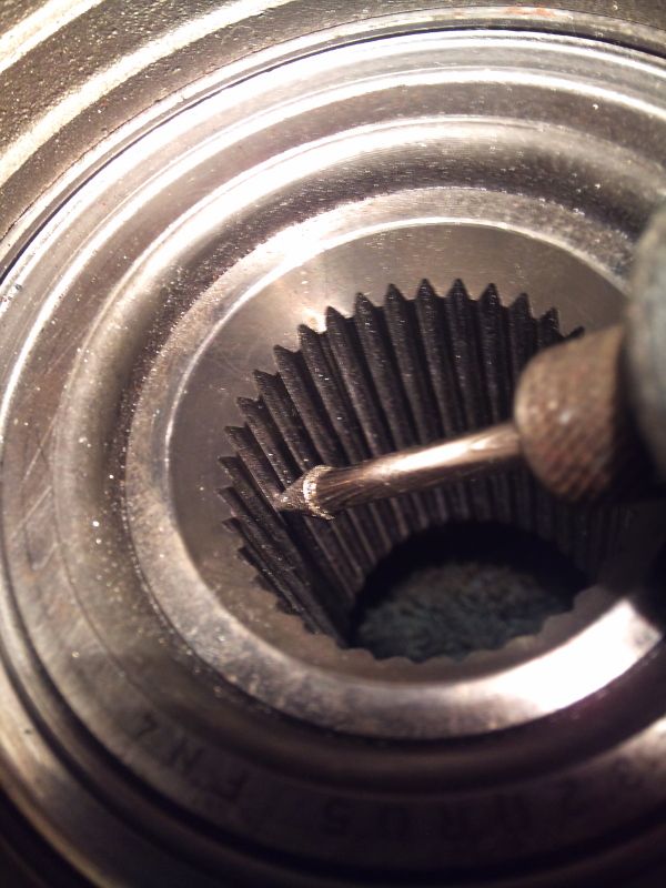

Jim Bowen 1 Posted August 22, 2012 (edited) Got the dremel out and sorted the splines out myself, Goes on lovely now, just a few gentle taps and it comes on and off like the other side does. What a palarva this has been. :lol: Found this dremel bit was a perfect fit Ran it up and down every spline a few times Fixed Edited January 31, 2013 by Jim Bowen Fixing Broken photo links Quote Share this post Link to post Share on other sites
