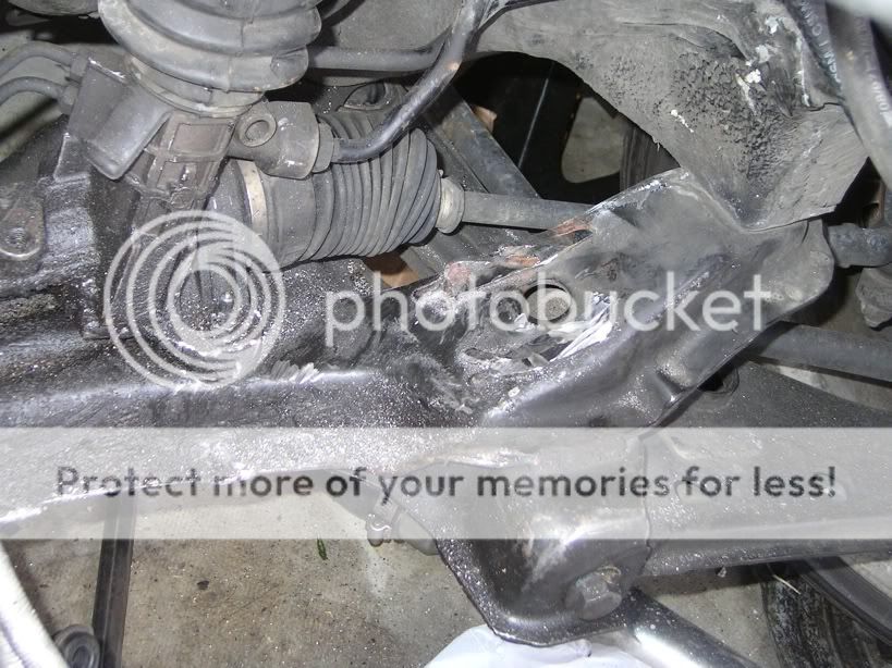

1.moving the transmission mount cup on the subframe approximately 1/2" to properly clear the larger 02m CV flange

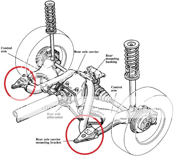

Axle (circled are the 3 bolt axle mounts):
a) 1992 Passat G60 (available in European and Canadian markets)
-A popular option for those in North America due to the relative ease of acquiring parts.
-Requires either modifying the rear of the car to accept 4 bolt axle mounts such as "MrDave" did:

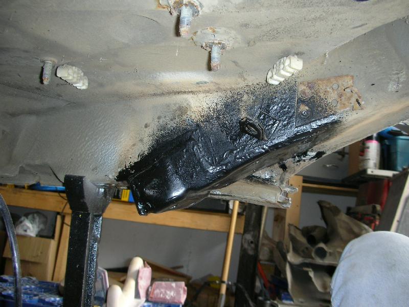

or the purchase of 3 bolt rear axle mounts from overseas which look like this:
-The floor and rear end must then be grafted in.
-With this setup you can use the stock fuel filler location.
-The downside is that you have a 70l fuel tank which hangs below the rear bumper.
