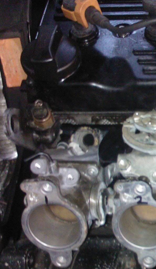

Just one thing - we have a sensor left which were having problems locating which is a thermo after run fan switch. Does anyone have any idea where tis goes on 2.0 16v 9a?
Cheers guys
The switch, does it look like a coolant sensor screwed into a small bracket? If it is it goes under the cam cover bolt at the front offside corner of the engine - closest to the metering head.

Yeah I think youve got the one... Its a copper sensor with a thread and is sat into a yellow bolt which is housed in a bracket!! if that makes sense.
Does it connect to a single brown wire with a connector that runs down the front offside wing (Near the metering head) then across to this sensor - as that brown wire is not connected to anything at the moment - so must be the one am guessing?
Thanks again!!!
Here you go, this is a photo of mine during conversion to ITBs. You can see the sensor. Mine no longer uses this, so I can't easily check the colour of the wire, but I am 99% sure it was brown, and 100% sure it was a single wire.

The picture hasnt come uo and wont let me see it, but buy the sounds of it I think we are talking about the correct one! the single brown wire is perfectly long enough to sit where you have said and it the only spare senosr wire around that area!!
Thanks again for your help - does the sensor then screw into the head and the bracket sits under the cam cover bolt??

Strange, it shows fine for me...
The bracket holds the sensor in the air. The cam cover bolt goes through the other hole in the bracket to bolt it to the head, just to the side of the lifting eye and just in front of the oil filler cap. If you want to PM me your email address I can email the photo to you.
