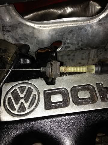

Saichy 10 Posted December 8, 2012 ive swaped my 9a's inlet manifold for a kr on earlier today since doing so my car will not start right or tickover either. everything is connect right and im at a loose end and need help asap. tried the 9a tb and the kr one and no difference. dont know if the throtle cable is worng now as i messed with it to get it off. here is how it looks now any advice welcome need to get it running by tomorrow afternoon. thanks dan ---------- Post added at 4:57 PM ---------- Previous post was at 4:44 PM ---------- Just to add aswel. When it does fire up if you rev it it sounds like its missing untill about 3000rpm but wont idle just cuts out Quote Share this post Link to post Share on other sites
CazzaVR 0 Posted December 8, 2012 Sounds like a vac leak to me- I would double check all the hoses and ISV. Quote Share this post Link to post Share on other sites
Saichy 10 Posted December 8, 2012 Best way of checking for leaks?? Take pipes off and refit? Look for splits? Anything else?? Driving me mad Quote Share this post Link to post Share on other sites
Wullie 1 Posted December 9, 2012 There is a large hose under the air feed just after the fuel distributer which fits into a grey valve. It's only a couple of inches long/ inch diameter, and will give your symptoms if disconnected. Quote Share this post Link to post Share on other sites
_Meth 0 Posted December 10, 2012 Its an air leak problem without a doubt. make sure manifold is sealed and every pipe around is also sealed & connected. Quote Share this post Link to post Share on other sites
tentonhammer 10 Posted December 10, 2012 Check the long thin breather hose that is connected to the dual thermostat located underside of throttle body air intake tunnel to the air box. Without this connected the car won't start for sh*t. Quote Share this post Link to post Share on other sites
