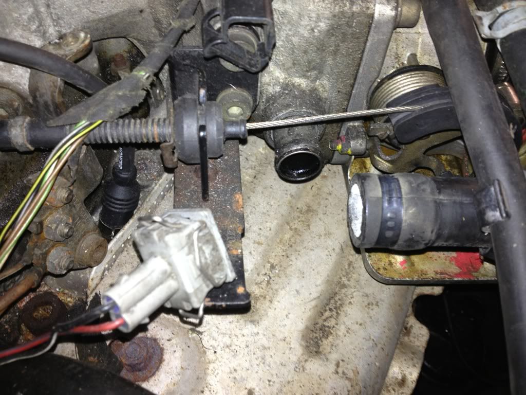

Think youre missing a bit of pipework too. There's also an isv damper but it is not essential.
Yours is obd 1 right? So it has a dizzy on the side of the head? In that case it I don't think it used a crank sensor, I thought the dizzy has a hall sender trigger for spark. Obd2 uses coil pack which uses crank angle right?
Plug both sides of the hose and manifold and the car will should start,just won't idle good especially when warm.the fuel pump should prime for a second when you turn the key so if you can't hear it check the relay.other than that the ecu relay is the only one you should check and wiring in the engine bay

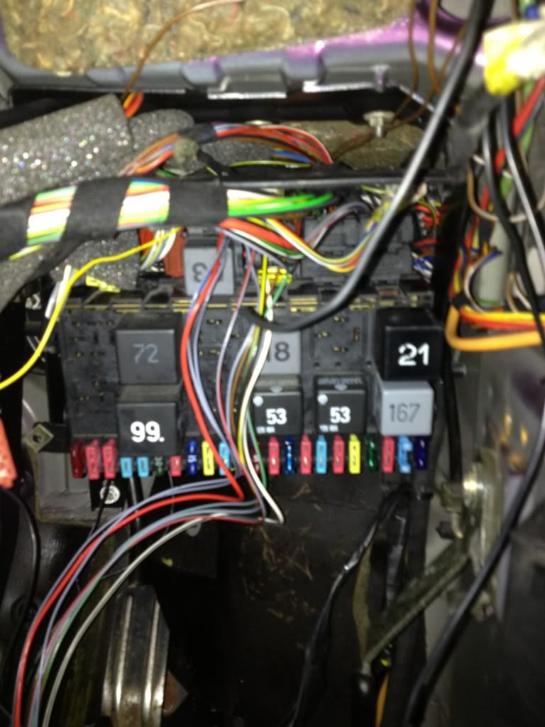

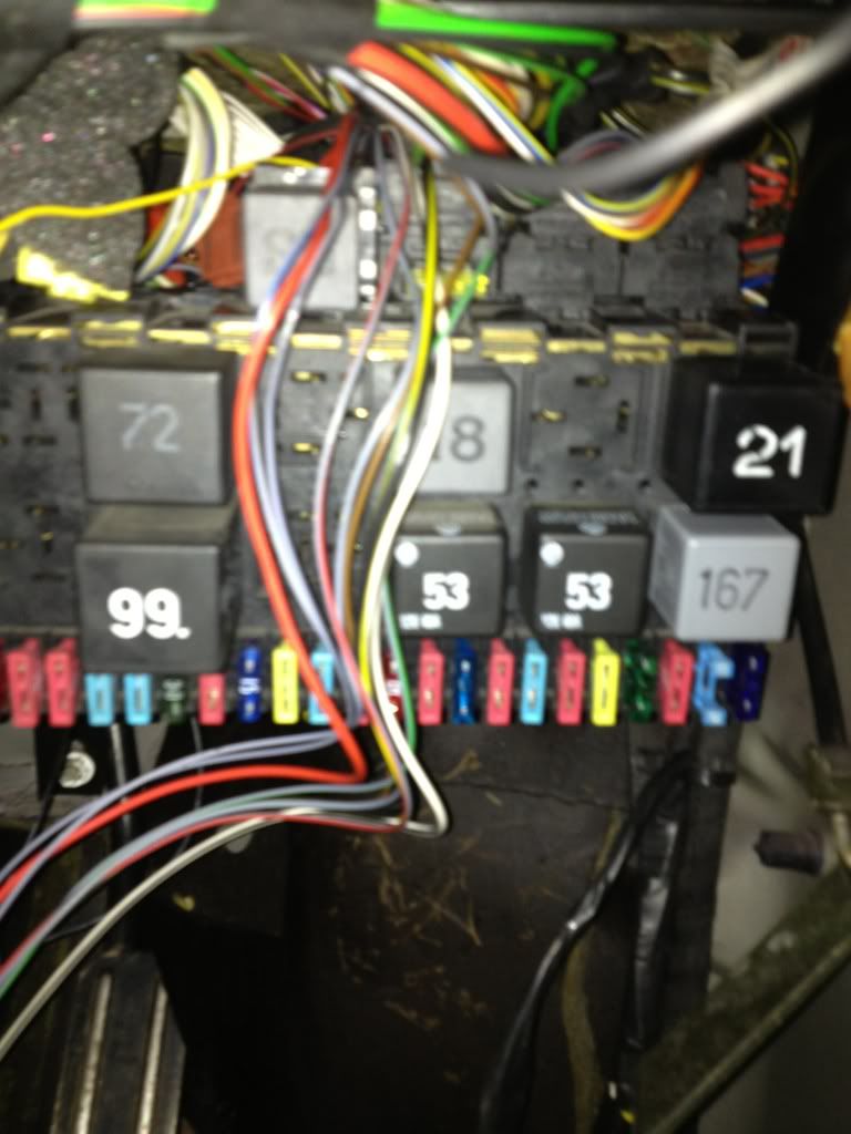

O right ok thank you mate I will try that next time I'm down the workshop I hope so, and I cnt hear my fuel pump priming but I'm pretty sure it's getting fuel in the head I have a pic of my fuse box dnt suppose anyone can tell me if I'm missing any relays
Put a finger on the 167 relay and turn ignition on.it will click as pump primes.no click,check the relay or lift the carpet in the booth and listen for the pump.no pump,no fuel

PS your missing your ecu relay :thumb right:
Should be relay 109 goes in position 3
