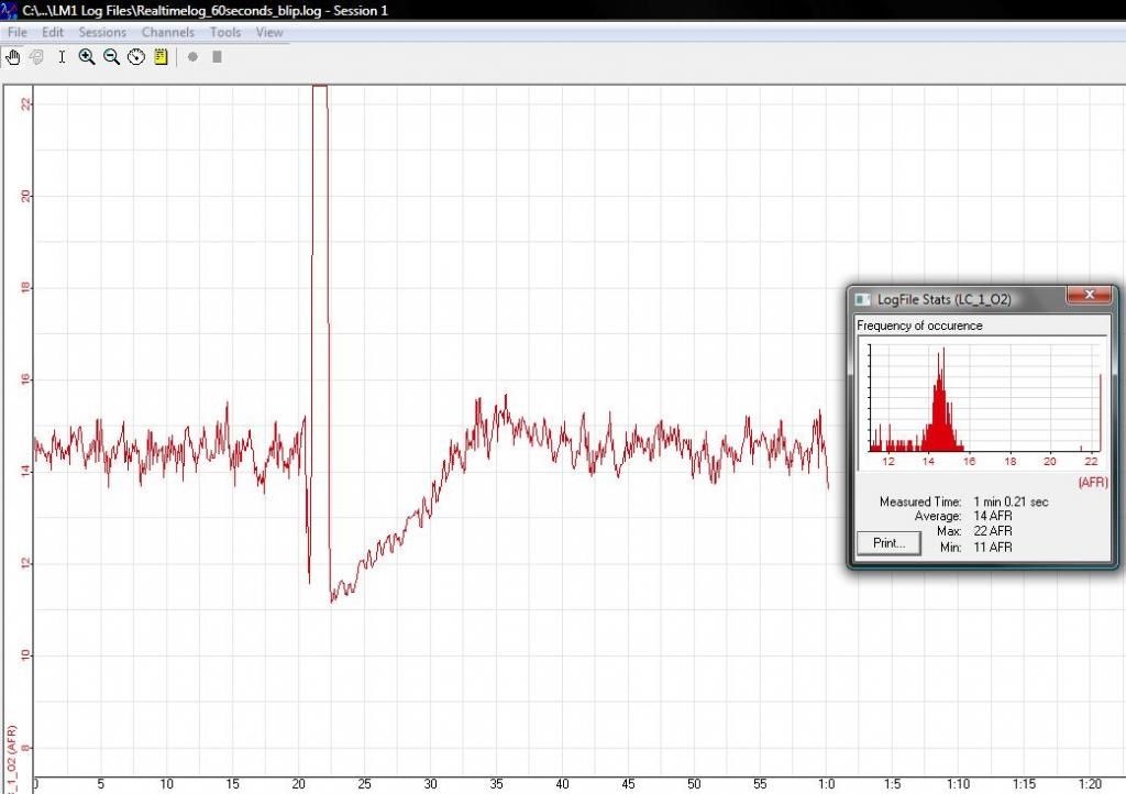

Sorted cheers lads. I brought the laptop inside with the cable plugged in and it downloaded some drivers. All's working now! Will get some logging done with the 68 and 65mm pullies.
[video=youtube;jHKJA9Ljp-A]
EDIT: Oh I got a quick log at tickover too, just gave it a full throttle blip. And I then downloaded the latest logworks 3.3.
The AFR's are looking quite good there (Very basic log I know) It does go slightly on the rich side with initial full throttle.
