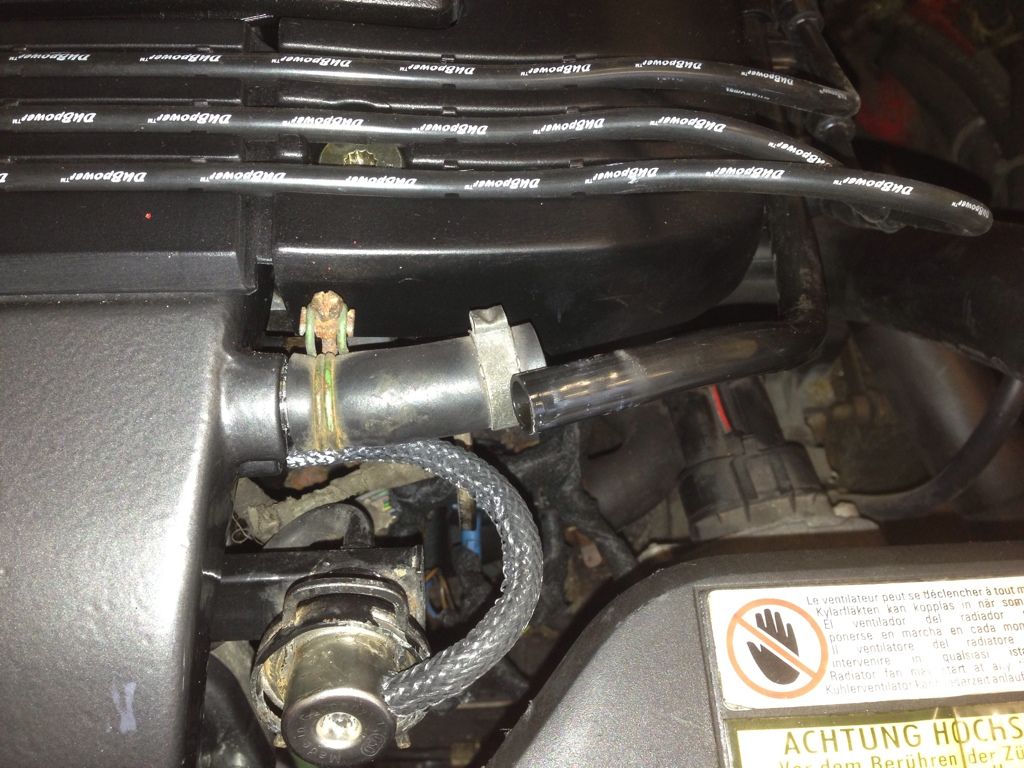

tonytiger 0 Posted March 9, 2013 I think the loose pipe you've found is part of the vacuum system - but it's been so long since I didn't anything useful on my car I can't honestly remember. It certainly won't help if it was loose though - so needs reconnecting properly. However, as has been said - if you haven't already, you MUST get this on diagnostics to see if it highlights any errors. I'd strongly recommend getting VAGCOM(VCDS) yourself (assuming you have access to a laptop) - or appealing for somebody local with vagcom to assist you. Apart from checking for fault codes, you can check some of the values that the sensors are returning/ecu sees. Quote Share this post Link to post Share on other sites
Overmind 10 Posted March 10, 2013 The loose pipe you have found is the vacuum pipe for the brake servo, it should not be covered in fuel. I would think it likely that you have no sparks at the plugs. So fuel is just being pumped in and not burning. I would suggest removing all of the spark plugs and checking them, if they are wet and smell of fuel then you know you are at least getting some fuel into the cylinders. Then clean the plugs up, make sure the electrode gaps look roughly the same (unless you have a set of feeler gauges and then gap them appropriately.) You can remove a plug and fit it to a lead and earth it like previously mentioned. BUT **please be aware that if there is neat fuel in the cylinders then when you turn the engine over it will come out of the open hole you just removed the spark plug from, and if the plug you are holding does spark near enough to the fuel......** So if you are going to test it that way please be careful. You can buy cheap testers from euro car parts and halfords and the like which you plug into the ht lead and earth it and it lights up, this gives a better indication in my opinion and is safer. Is your car fitted with a distributor or coil pack? VAG-COM will always list a fault code for the crank position sensor on OBD1 engines if the engine isn't running. The usual symptoms of a faulty CPS are the engine will fire for a second and then cut out. Hope this helps. Bryn. Quote Share this post Link to post Share on other sites
