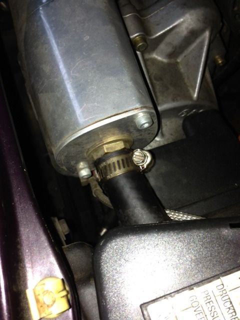

Am wanting to refit the original pipe that runs from the passenger side of the charger to the cam cover breather.
The question I have is....as you can see from the picture there seems to be some sort of sealant around the aftermarket plate and I am wondering if I take it off I'll need some sort of gasket to refit the original plastic pipe?
Cheers.
Can't see the picture for some reason (probably my work PC not letting me). The original plastic pipe should have an oring on the end of it which fits into the charger - I've not seen one yet which didn't. Personally, I would not be happy with having any form of sealant near the charger inlet, so would want to get it changed ASAP.
