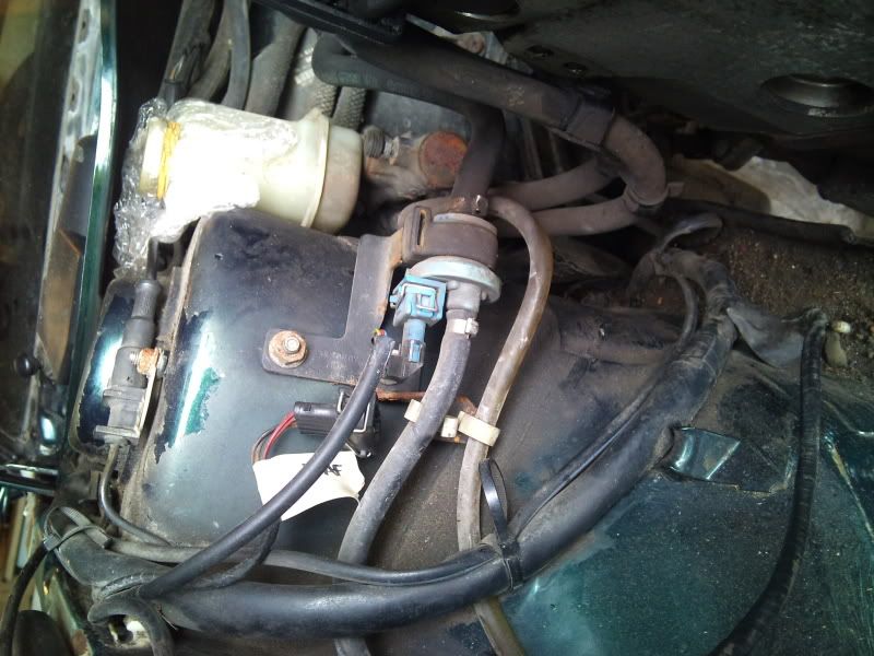

Very very helpful! The left hand side of the picture show clearly the routing. :thumbleft:
Thank you.

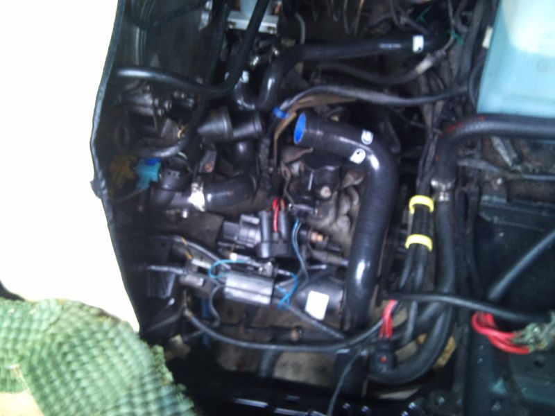

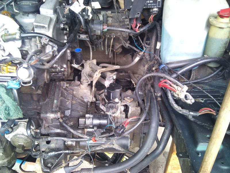

Has anyone got anything for the nearside routing (turret and chassis leg) please?
Brilliant. Thank you.
That covers the nearside turret, loom to engine harness and also the nearside chassis leg. I believe.
