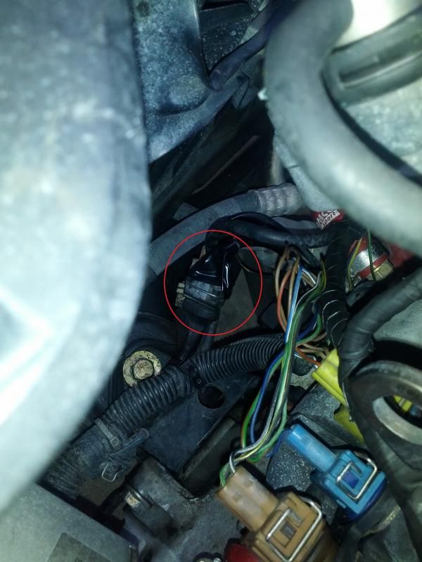

After replacing my brittle wiring harness with a fine pre-owned model, I found that one of my connectors (not related) simply fell apart. I am sure this is due to the insane heat that VRs run at and the fact that the car has 345k on it so far. I know I can drop the front end simply enough - but dont have the time right now. So for the interim, can anyone tell me where the connector circled in red below goes to? It is the taped one, right next to the brown connector that goes to the front knock sensor:

Pretty sure its for the crank sensor mate. Trace the cable to the bottom front of the block, and its a small cylindrical sensor that the cable sits at a right angle to. The sensor where it joins the cable are notorious for breaking down and shorting causing non running. It generally happens when the engine gets hot, but its not uncommon to happen with the symptoms you describe.

In doing some searching around I cannot figure if its the crank sensor or the knock sensor. I could of sworn the brown connector goes to the sensor closest to the transmission.
I found this with a quick search:
So which is which? And is it possible to interchange the two sensors? Gonna have to take a better look at it.
I know this posts a little older but in that picture the green arrow is where the oil filter housing connects to, the yellow arrow the oil cooler and the red arrow is the crank shaft sensor.
