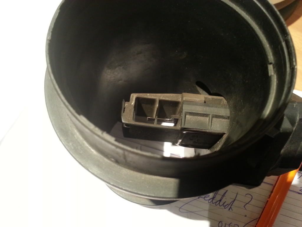

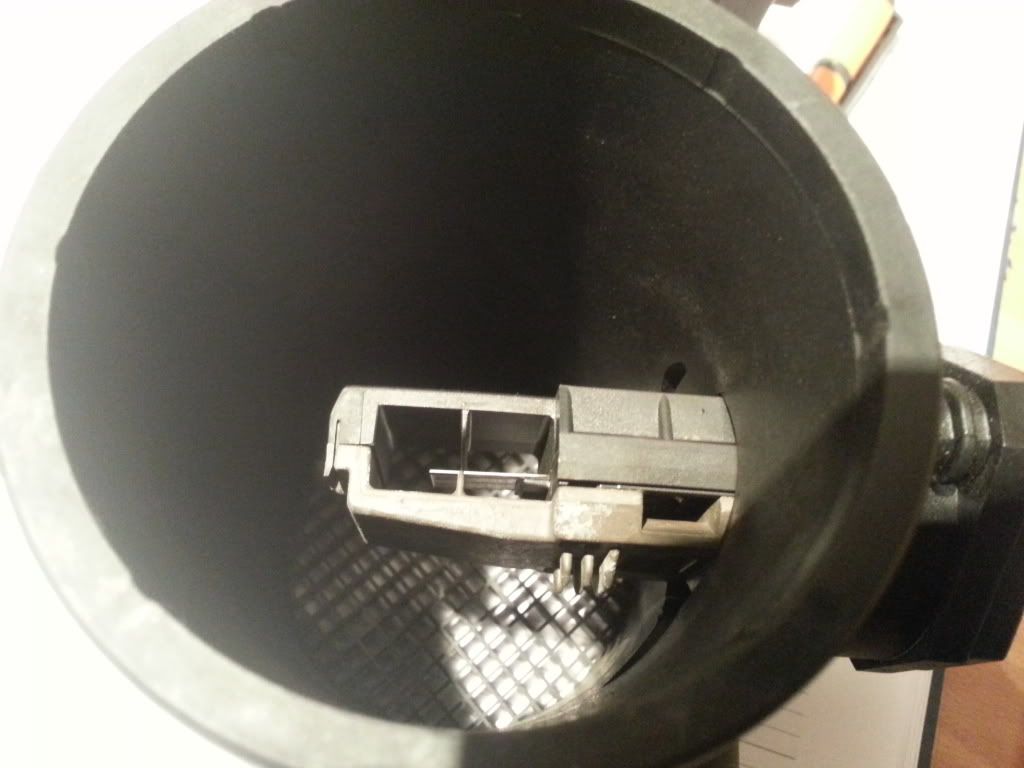

dj b 10 Posted May 16, 2013 Hi Rams na your ok mate. its my fault not yours so dont worry about it. ive got it booked in next week to a tuner to see what he can do. hopefully he can fix it. hes got a vagcom so fingers crossed. No i didnt use the tool as I didnt have one so I improvised with an earth cable and pulled them up with that (making sure i didnt put any stress on the lead only on the metal part. and i made a thing from copper tube to pysh them down with. ill double check they are all the way home but its been the same before I changed the plugs or leads. Ive always ran uno turbos and im great with them but always loved the rado's and this is my first one. ive been through the forum to find a solution but cant pinpoint it. ---------- Post added at 8:30 PM ---------- Previous post was at 8:17 PM ---------- looking at the maf I think they are different, the one I had from you rams looks like a diff sensor. it looks a little shorter ill take a pic of the two and put it up. Hopefully it is the maf as they are different. ---------- Post added at 8:41 PM ---------- Previous post was at 8:30 PM ---------- ok here the pics this is my old one and this is the one from you rams it definitely looks different. the sensor doesnt look as wide. ---------- Post added at 8:45 PM ---------- Previous post was at 8:41 PM ---------- they are the same part numbers though :bonk: Quote Share this post Link to post Share on other sites

Kevin Bacon 5 Posted May 20, 2013 MAF. Try a new one. VR6s are unbelievably picky with MAFs. Quote Share this post Link to post Share on other sites
dj b 10 Posted May 21, 2013 Thanks mr Bacon. ive ordered a new one just in case that should be here on thursday so ill update the thread then. hooefully itll sort it but im not convinced anymore. anyway fingers crossed ;-) Quote Share this post Link to post Share on other sites

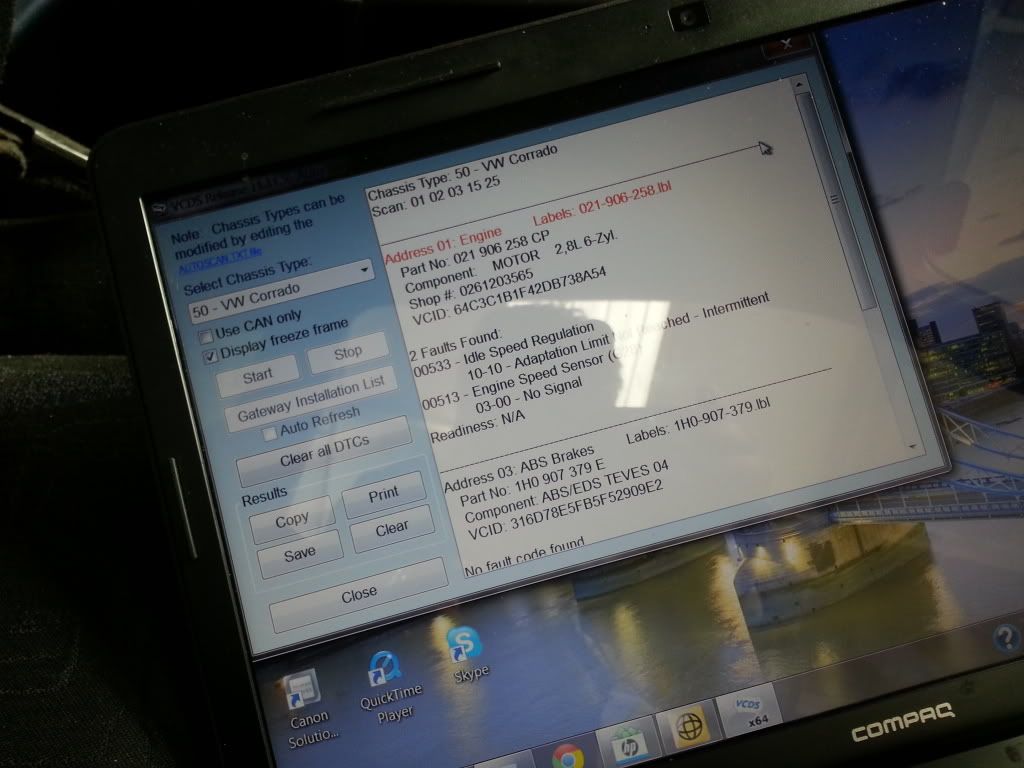

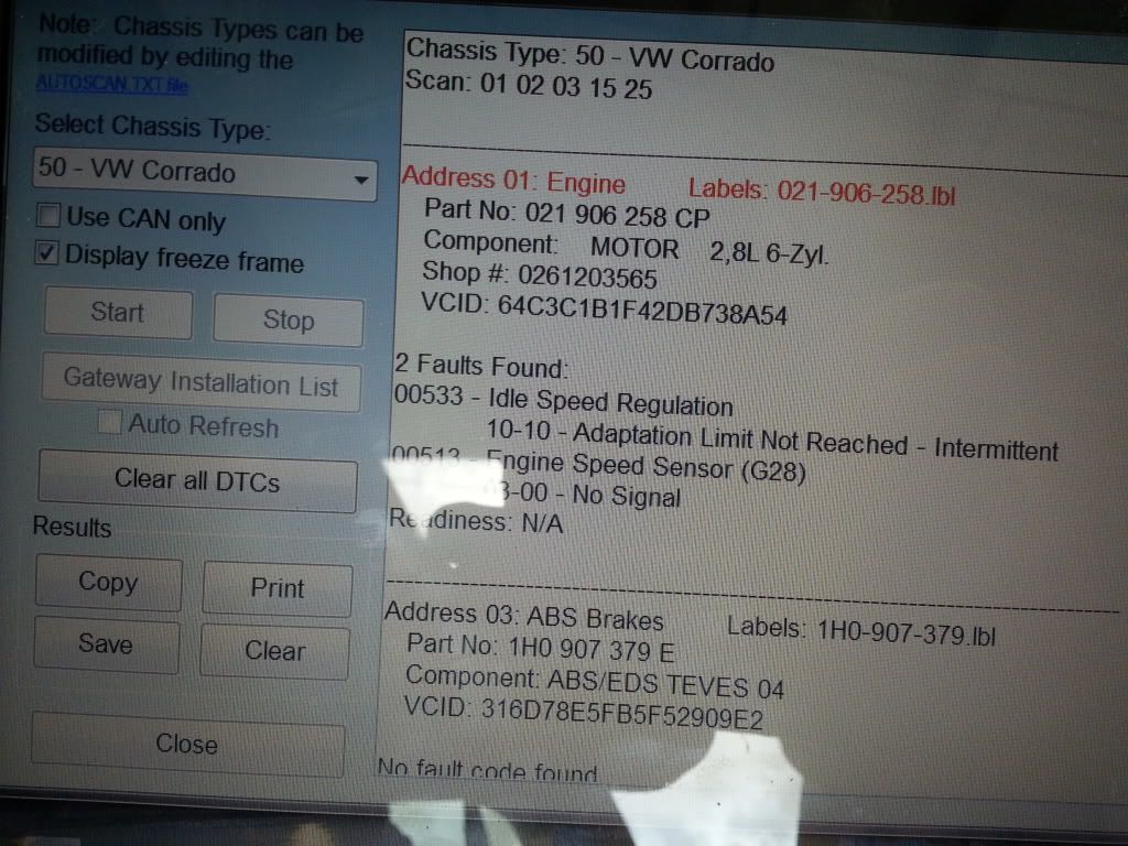

dj b 10 Posted May 23, 2013 ive been to another garage today and they put it on the vagcom it came back with a idle stabiliser problem and an engine sensor. does anyone know what I need to get from these codes? any gelp greatly appreciated Quote Share this post Link to post Share on other sites
fla 9 Posted May 23, 2013 (edited) I assume you cleared the codes first, ran the engine and then rescanned? They may be old error codes. The car will always present the engine speed sensor code when the engine is not running. Also, remove the throttle position sensor,clean out the throttle body, both sides of the butterfly and refit. Then do a Basic Settings procedure. Is the throttle damper ok? Its called a dashpot and there are quite a few threads about adjusting it. Edited May 23, 2013 by fla Quote Share this post Link to post Share on other sites
dj b 10 Posted May 23, 2013 yes thats right mate. the first time we ran the vagcom it brought loads up so we reset them and went for a little drive. then tested it again and these 2 are the only ones it came back with. I cleaned out my isv afterwards and it was running terrible although after a drive is got slightly better. I have put up a wanted post for a good icv so hopefully a good one will turn up and I can try that. Quote Share this post Link to post Share on other sites
fla 9 Posted May 23, 2013 sorry, just amended my post above! Make sure you lube the isv properly after cleaning otherwise it will not run smoothly. Quote Share this post Link to post Share on other sites
dj b 10 Posted May 23, 2013 Thanks for the advice mate. ill try those things tomorrow. :thumbleft: Quote Share this post Link to post Share on other sites
