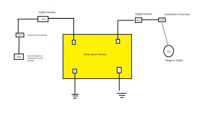

Just thought I'd add a small pic I made, maybe someone can confirm I'm on the correct path here (as far as I can read from bentley this is the setup for the yellow temp sensor)?:

well I have worked for VW/Audi for 23 years as a technician, and this fault from my experience points at a problem between the dash insert plug and the coolant sensor (pin 2) on your diagram. It looks like the wire runs through the relay/fuse box, so there may be a issue here? I would advise you check wire with a multimeter, and check for resistance down the wire when disconnected from sensor. or try running a new wire between dash plug and temp sender.

Can anyone tell me what the 3 and 5 indicates in this wiring diagram (snapshot from bentley):
I'l answer my own last Q - The 5 means relay position 5, and pin 3 on that relay :)
And FINALY!!!!!!!!!!! The problem seem to be gone - for some unknown reason someone have put a relay number 72 into position 5 - where it's supposed to be a relay number 43 (or non at all?), presume it have had a coil that's made a circuit to ground and feeding the gauge :)
