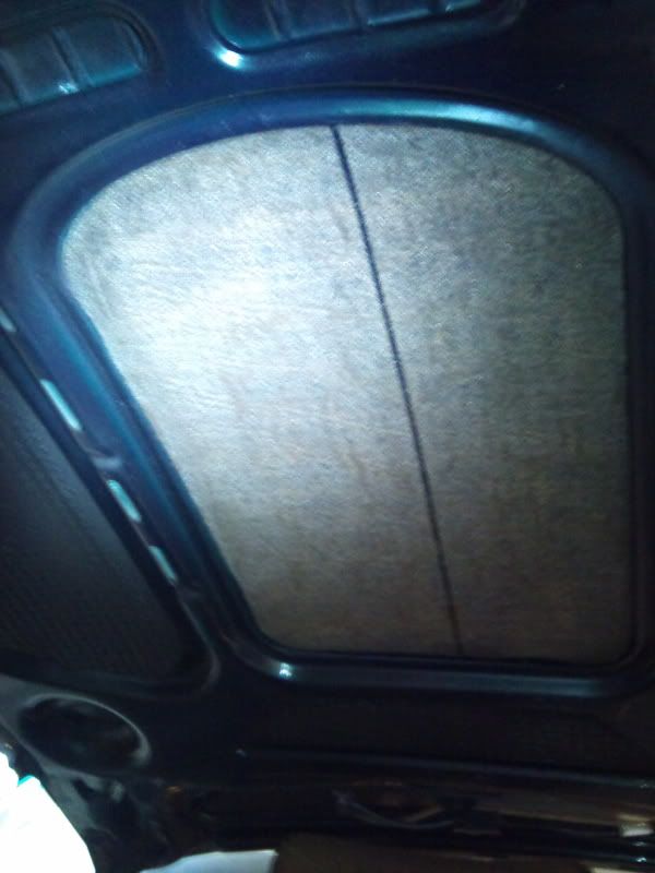

Crumbly old foam

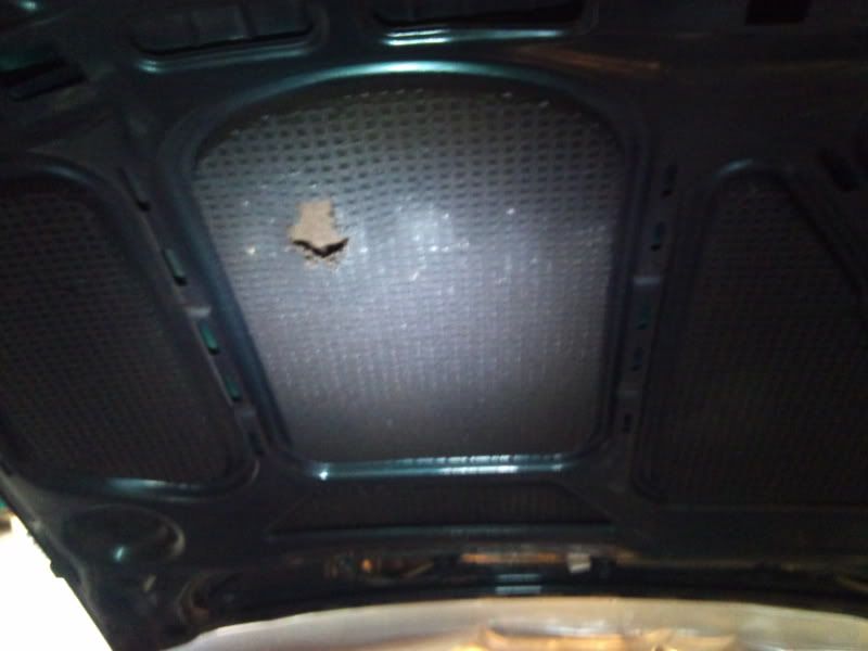

Covered up engine and scrapped foam off
Was left with the original layer of glue, which i softened up with white spirit and scraped off with old plastic windscreen scrapers, Takes a while
All removed

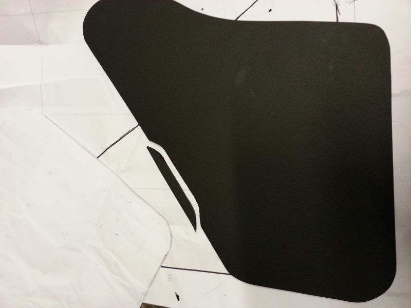

The bit i had to trim

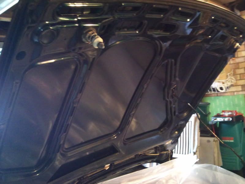

All fitted
Thanks for that Jim, didnt fancy taking the bonnet off. Looks like you've done a nice clean job.
So did you just spray the glue onto the back of the new foam, and not the bonnet as well?
Yeah, i just sprayed it on the foam, you get a few minutes to slide it around and get it in the right position.
The only piece i'm having trouble with is the bit on the left side has you look at my last pic, keeps coming unstuck in the bottom right corner as it meets the hump in the bonnet.
