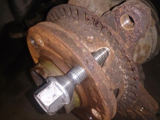

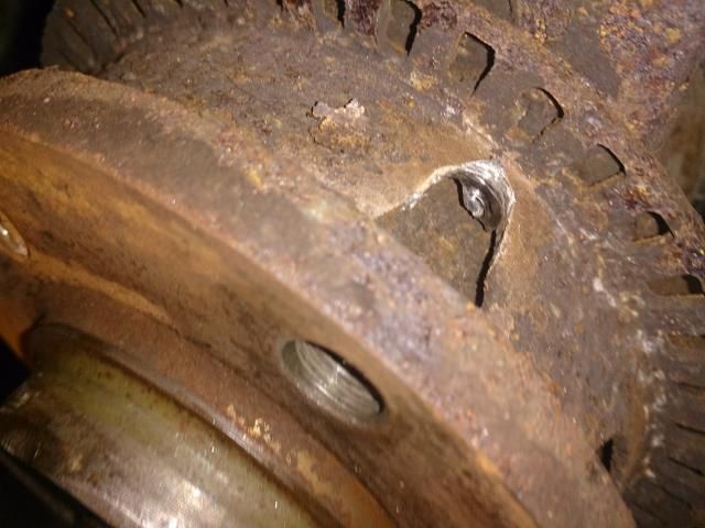

hi guys update i took the disk and caliper of and found the problem as the pictures show. They have screwed the wheel bolts right into the inner hub and because they have forced the bolts in it has badly bent the guard meaning its rubbing badly on the bottom of the hub and the abs sensor making the horrible noise. Also the wheel bolts pushing it away has ruined the threads on the screws that hold the guard on what is this piece for i couldn't go any further without a hub puller on the plus side fitted a slave cylinder just need to bleed the clutch thanks ross

From the looks of that, I would say that only your ABS ring has had it. Fairly cheap part but heavy on the labour due to having to remove the hub from the bearing to replace it. I'd fight for a new bearing as well as the chances of it being ok after this little episode are quite low, especially if they pull the hub out and refit it.

​If you are mechanically minded, it's not a tough job to replace the whole hub carrier assembly.
yeah i am thinking of replacing the whole hub carrier after being offered one for a reasonable 10 pound. But i am going to wait to see what the garage have to say for themselves tomorrow i don't want to name and shame until i give them the chance to sort it tomorrow because now i have it apart i fail to see how they can deny their mistake thanks Ross
