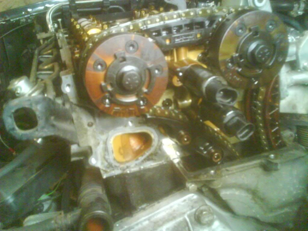

hi guys, noticed an oil leak the other day on my 24v 2.8 , so decided to have a butchers today , with next to no room to look I whipped the front end off along with inlet manifold and thermostat housing as it seems to be coming from the upper timing chain cover but there is oil dampness on the front right corner {right next to the timing chain cover/thermostat connection} of the head gasket which ties into the oil dampness of a possible weaping chain cover , is it physically possible for the head gasket to leak from this area ? or is it more then likely coming from the chain cover and running along the head gasket and then down the front of the block??, iv removed the chain cover and it wasn't sealed with any gasket or sealant so im hoping its that , thanks....

The small spill of oil you've got on the front edge of the lower chain cover close to the thermostat housing,
that could be where it's run down off the inside of the upper chain cover.
You've said you couldn't see any signs of a gasket on there, but were there any signs of sealant used or not ??

cheers si, the head gasket is intact and nothing missing, iv searched through a ton of pictures of bare vr6 blocks and heads and on that corner there seems to be a coolant passage and not oil so its safe to say that its pretty much impossible {nothings impossible but you know what I mean} for the head gasket to leak oil like I was suspecting with mine, but yea im goning to order new seals for it and clean it all up and re seal :) , I was prepareing myself for timing chains + guides + new clutch but don't fix what aint broken is now my new motto ...

yea I looked at the top 2 tensioner guides and theres hardly any wear into them surprisingly, im replaceing the hydraulic tensioner though as that seems rather rough to compress and has wear marks on its shaft {ohh errr}
