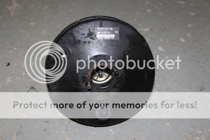

Rams 0 Posted December 21, 2013 Can it be checked with a volt meter? Is there a 2 pun plug at one end? I've never seen one up close. Quote Share this post Link to post Share on other sites
StueyB 0 Posted December 21, 2013 I can't say I know the answer to this...but would defo like to. Let me dig through some pics and I'll have a look. Pretty sure there is. Quote Share this post Link to post Share on other sites
StueyB 0 Posted December 21, 2013 Answer is yes: Quote Share this post Link to post Share on other sites
