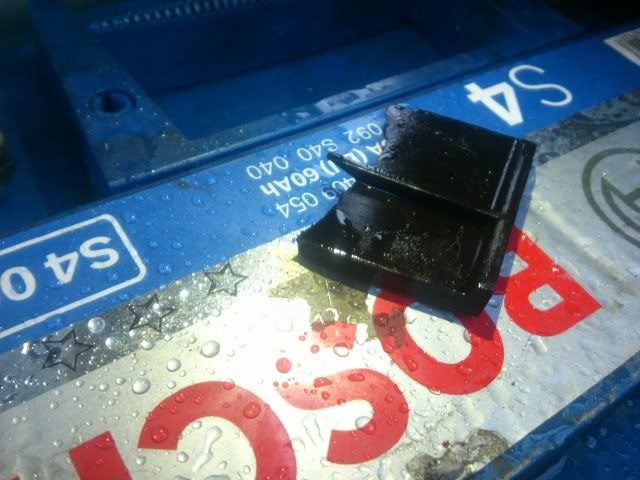

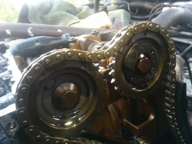

kerrly 0 Posted February 9, 2014 The weather has been dreadful but I managed to get the cam and tensioner covers off....result... not good. It's tensioner failure note damage to the area around the top bolt and a 3inch section Managed to recover this part. too dark and crap now to continue, at this stage I have 4 more manifold bolts to undo and the headbolts and the head is off. At that point I can decide how far I need to go. 2nd hand head/clutch/tensioners or 2.8 VR, or VW heaven. Quote Share this post Link to post Share on other sites
Roger Blassberg 0 Posted February 10, 2014 Where's the bottom chain? RB Quote Share this post Link to post Share on other sites
dr_mat 0 Posted February 10, 2014 .. yeah and I thought the top end had a dual chain setup on the VR6 .. ? Quote Share this post Link to post Share on other sites
iceviolet 0 Posted February 10, 2014 It looks like the later chain set up normally found in the 24v engines with the single chain and solid polymer tensioner instead of the steel and riveted plastic that the 12v engines have. The bottom chain has gone so unfortunately it's best to get the engine out and assess the damage. Quote Share this post Link to post Share on other sites
dr_mat 0 Posted February 10, 2014 .. that's what I thought. Anyway, your big problem is the bottom chain, not the top tensioner! Quote Share this post Link to post Share on other sites
Roger Blassberg 0 Posted February 10, 2014 The bottom chain has clearly broken so it is a gearbox/clutch/flywheel/bottom timing cover removal scenario. Pray that the chain sprocket on the crankshaft hasn't been damaged, because it is not removable or repairable and you would need a replacement crankshaft. As above comments, you clearly have a replacement simplex top chain arrangement, maybe an AAA 2.8 engine rather than the original 2.9 ABV. You'll need to check the head for bent valves particularly as you have no compression on at least one cylinder. It's an unusual failure to break a chain, unless the bottom tensioner failed completely and the chain was repeatedly snatched from tight to loose. A rebuild is going to be expensive especially if the head needs work and the crankshaft sprocket is damaged too. A reasonably fresh second-hand 2.8 AAA looks to be your cheapest option. Best wishes RB Quote Share this post Link to post Share on other sites

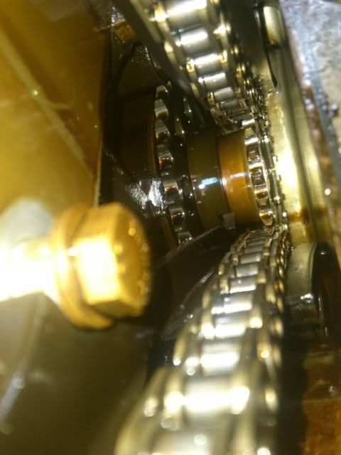

kerrly 0 Posted February 11, 2014 Thanks for all the feedback. Just to give you a bit more information about the later cam chain set up , the car had a new engine fitted at VW in 2002 (the short engine is listed as £4600 +VAT on the invoice and along with all the other parts replaced comes to over £6500! Having checked all the MOTs the engine has done around 100k. Hopefully I should have the head off at the weekend and can go from there. looking at this picture then, worst case now appears to be a snapped bottom chain which if the chain has then ended up wrapped around crank could have made a huge mess of the bottom end. It would be an enormous shame if the bottom end is dead! Ummmmm , I feel i can justify upper/lower chains/tensioners, HG, clutch, rebuilt head as i can most of it myself. Part of me thinks if I buy a cheap 2.8 it would be wise to do chains/tensioners/HG etc on that as well so I don't think I'd save a huge amount ,I'd be down on power and it would make the car less valuable come resale time. Quote Share this post Link to post Share on other sites

Roger Blassberg 0 Posted February 12, 2014 If I were you I I would first take off the gearbox /clutch /flywheel/bottom casing to see what has happened to the bottom chain sprocket.If it's worn, which may have been why the chain failed in the first place, you will need to budget for a new crankshaft.Be really scrupulous in inspecting this sprocket, if it is worn it will kill a new chain quite quickly and you will be wasting your time and money if you skimp on this detail. This will probably determine whether you decide to carry on with the current engine or go for a replacement. (Don't forget when inspecting it that there is one tooth that is filed partly off to give a timing mark, so don't condemn it on that evidence alone.)Of course the crankshaft from a 2.8 will go into a 2.9 as it is the bore diameter alone that differentiates the two capacities. Good luck RB Quote Share this post Link to post Share on other sites

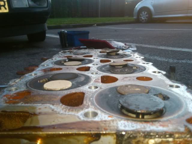

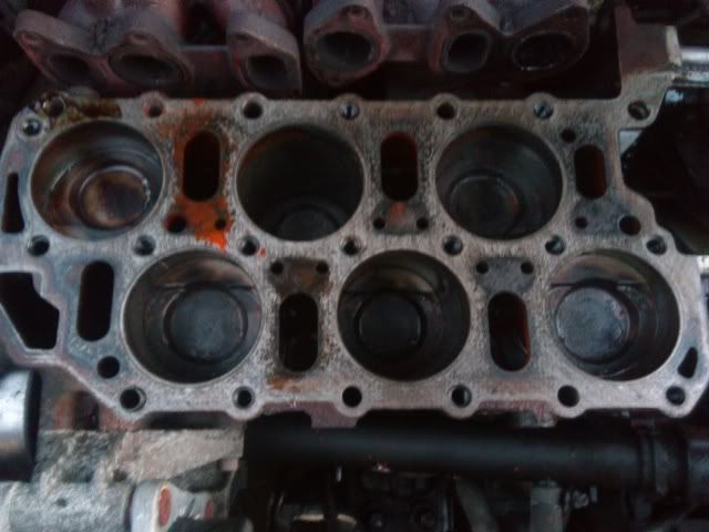

kerrly 0 Posted February 16, 2014 Got a chance to spend a bit of time on the car today, slow progress due to the hangover from hell. Head is off.......... and the results are..... Which meant it was time to look at the pistons... No damage to any pistons was a very pleasant surprise. Plans now is to port match the head before sending it off to be stripped, new triple cut valves, stem seals and a light skim/clean up. Whilst that's being done, the flywheel will be lightened/balanced, new clutch sorted and strip the bottom end. At this stage im still completely unsure what I am going to find!!!! I'd love to use now as an opportunity to put a 6 branch and set of cams in to but that would eat into the G60 fund too much. Finally, as i'm going to start ordering parts what is the deal with the Mk4 2.8 24v Headgasket? Quote Share this post Link to post Share on other sites
