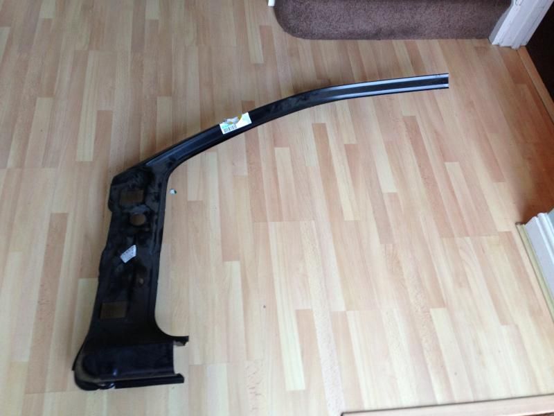

that winscreen surround looks nasty, I needed to do some repairs to my screen surround and the bottom of the A pillar so I bought the panel from VW classic parts in germany, was only £50
Edited by rado20vT
Mine was already cracked up in both corners and badly delaminating. Yeah seen that repair A panel on here somewhere the other day while researching as it'll be near impossible to get that area right just fabricating a section. There is a raddo being broke not too far from me so i'm going to check that out and maybe cut a piece out of it if it's any use.
