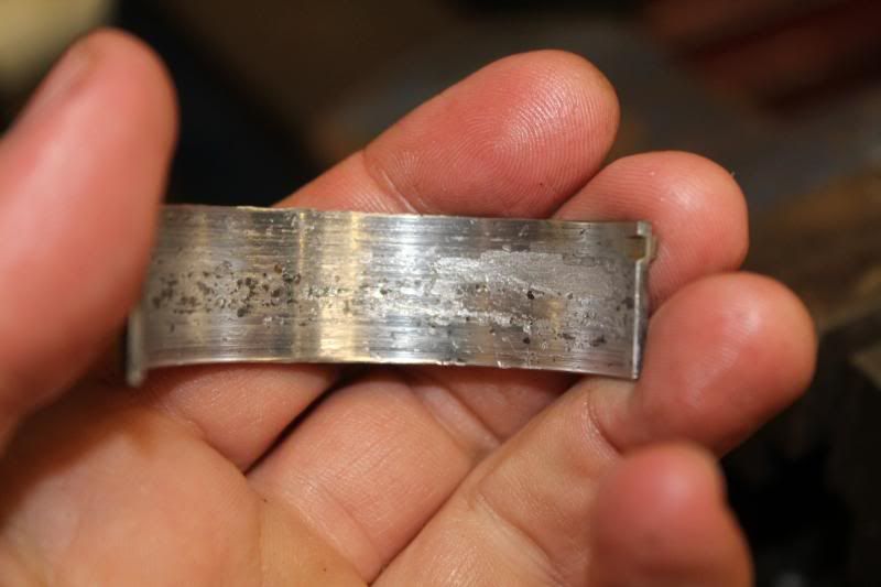

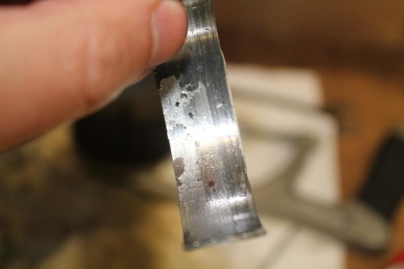

And finally we have an answer...
Big end bearings...
I've only dropped no 6 so far but I assume the rest will be the same...
I'm actually quite pleased, at least I now know what's wrong and it's not too difficult to replace the shells, the crank is undamaged, I think I've caught this just in time.
Ok, next question, where can i get replacement shells and what do you think has caused this?? the only thing I've done is change the oil although the oil temp does go quite high (124 was the highest I've seen) was the replacement oil maybe too thin for a 138000 engine (10w 40), oil pressure has never been low... any ideas??
Rog.

Check the main bearings as well. If there was oil starvation they will have been damaged too, but you'll have to take the crankshaft out to do them.

Primary cause of shell failure - oil starvation. I don't want to cast any aspersions as it's a member's old car, but it can occur through neglect or hard cornering with a low oil level. 1 or 6 dies first, depending if it's a left or right hander. If 3, 4 & 5 are less worn, we have the cause. VR6's don't have baffled sumps and a couple of members lost rod bearings on track days because of it.
