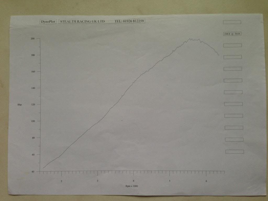

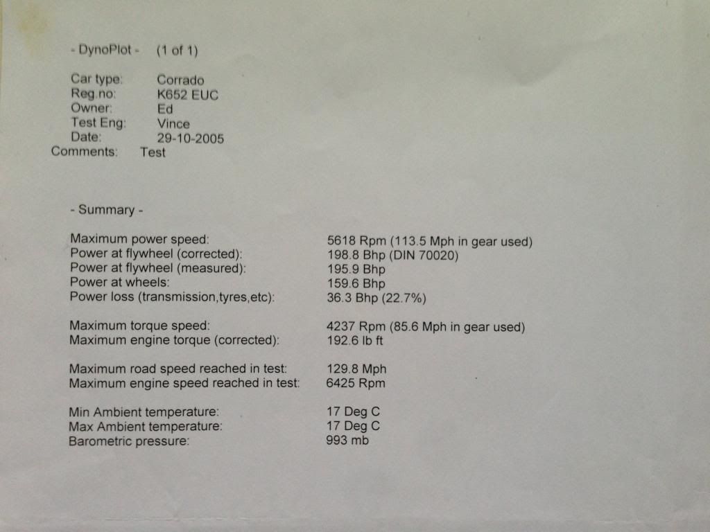

maff 10 Posted March 7, 2014 Great info chaps, my good friend has a mk1 golf vr6 which is one of his many projects, he also says that fitting a steel mk4 head gasket yields 5hp on its own, never heard that one? So if I fit them myself and then take it to stealth for a remap I should be fine. Would love to get my top end back as I have a very linear power curve looking at a dyno sheet for the car, it does have loads of low down grunt compared to a standard vr but I definatly do miss the top end Here's the last dyno I had for the car Quote Share this post Link to post Share on other sites
Kevin Bacon 5 Posted March 7, 2014 The MK4 gasket increases compression ratio slightly as it's thinner. Not sure that would yield more power on it's own though. Yep, stick the cams in and then roll it on up (or down, east, or west!) to stealth for a map! Quote Share this post Link to post Share on other sites
dr_mat 0 Posted March 7, 2014 Power curve is always linear since power (BHP) = torque (lbft) * RPM / 5250. For me, the torque curve is the one you're interested in. As others have said the main reason people went with the 263s was price, but they come very close to what the Schrick 268s can do at the top end and as an added bonus they pad out the torque curve right across the range, which the Schricks don't. The 268s are designed to be used with a Schrick inlet manifold however so when combined it's a pretty potent package. The manifold pads out the torque in the midrange and the cams take over for the 4000-7000 rpm sprint. If, however, you're offered them cheap and you can fit them yourself.. well why the hell not? :) Quote Share this post Link to post Share on other sites
