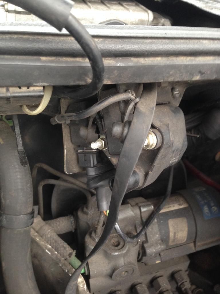

Right so I've tested for spark an there isn't one coming from the ignition coil so I went to change that, an got one from europarts, but I got given a square one so took it back said it's not right they didn't believe me so I just got my money back went to gsf really helpful they found the cylinder shaped one but the one I'm replacing is an odd shape not a cube or a cylinder, my corrados a 95 valver should it have the cylinder shaped one? I'll post up a picture of the one in mine at the moment
