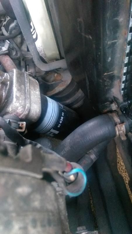

The oil level is healthy and has been recently changed using 10w 40 comma semi synthetic (not by me) and a filter that I haven't been able to identify (pic below).

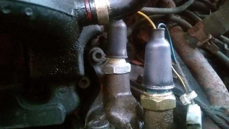

Yeah that's the sensors in the picture.
The yellow wire is for the oil pressure light on my G60, not sure if it would be the same wire on the 16V.
If the other wire is green/black that's for the oil temp for the mfa
