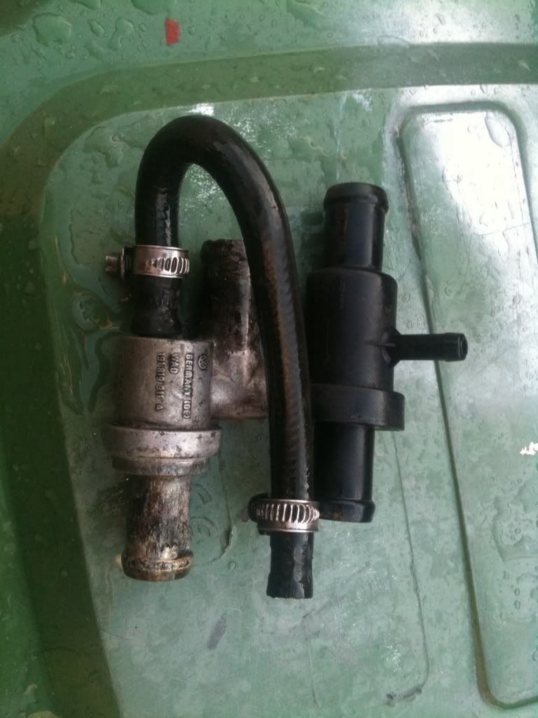

seanl82 23 Posted December 17, 2014 (edited) They were added years back as the matrix could sometimes fail and spill hot coolant into the cabin. The valves are pressure relief valves so should the water pressure become too high, it was diverted from the inlet pipe to the outlet pipe. (not flowing through the matrix). Newer matrixes are much more reliable and better put together, so the valves were not needed. To test, just remove both valves and the pipe that connects the two, and run some copper pipe directly to the matrix in their place. This obviously ensures the water passes through the matrix. Found a pic of my old valver when I did it. Remove these. Edited December 17, 2014 by seanl82 Quote Share this post Link to post Share on other sites
Drucey 10 Posted December 17, 2014 Thanks so much for your help. If this fixes the problem will it no ok to run without popping the heater matrix? Mine is a 1989 car (g reg) it is very well looked after tho. Hoping I can do this without the hassle of changing the matrix. Can you remember the size pipe you used? B&b will sell the pipes I'm guessing? Awesome help m8!! Thank you. Quote Share this post Link to post Share on other sites
seanl82 23 Posted December 17, 2014 I can't remember the diameter of the copper pipe sorry. If you measure the inner diameter of the hose that should give you an idea. It'll be OK running it short term I expect, but I'd change it out before too long. If the matrix fails, it'll spill hot coolant all over your feet and will steam up your windscreen pretty sharpish! If you have confidence in your matrix go for it. In the short term it's worth a try even if it just pinpoints your problem. Quote Share this post Link to post Share on other sites
