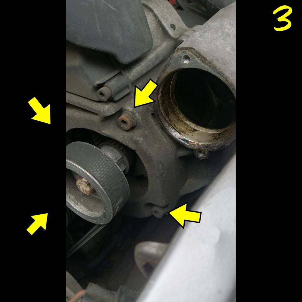

I'll grab a set of those tomorrow to try but if not I may have to bond the driver into it and try that. Here is a pic I've taken from the how to guide on there which was a great help today just to show which bolt it was (bottom left)
Ah it's Allen keys. Try hammering a torx into it? I had an absolute nightmare of a rounded Allen key to get out before, tried bonding a torx in with chemical metal and it never worked so I had to weld one in.
The bolt grips should still work on them as long as the socket fits.
Thanks guys I will try it and see what happens. At this rate I'll be taking the passat to ultimate dubs and not the rado :-(
i had same problem recently i whacked a multi spline socket over it with a hammer then just undone it
