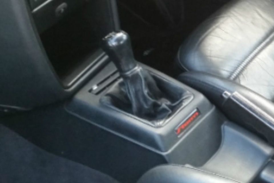

The bit on the gearstick surround should have a Karmann sticker on it.
Found some ebay pics - awww thats what they look like

Storm badge is there of course for Storm versions. I think all others have a Karmann badge there.

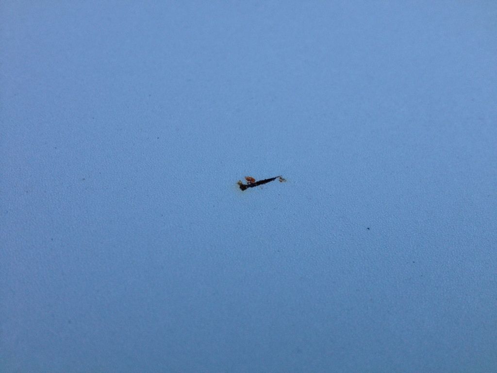

My car is dirty and with rusty spots
I know its USELESS and waste of time trying to de-rust and wax at these ridiculous temps,
But what the heck - something better than nothing!

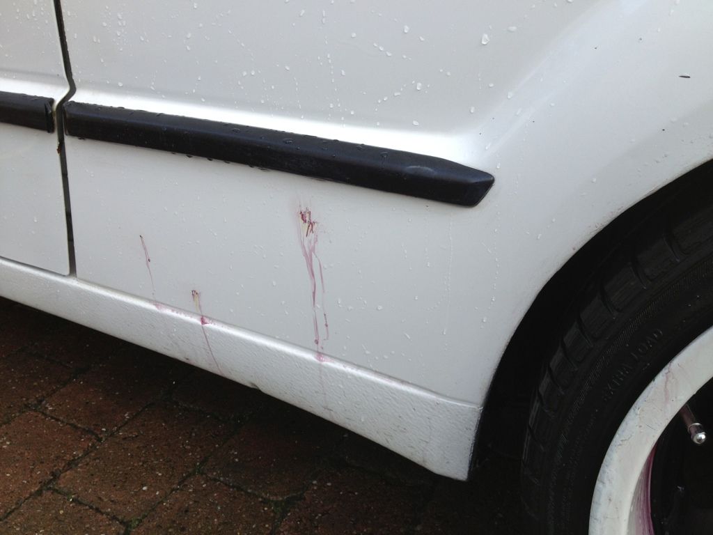

De-rusting:
Ok
De-rusting worked!
...10% of its cleaning power :(
LOL
As expected!

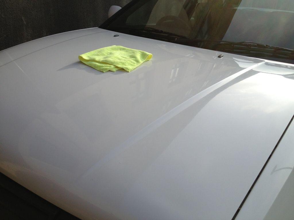

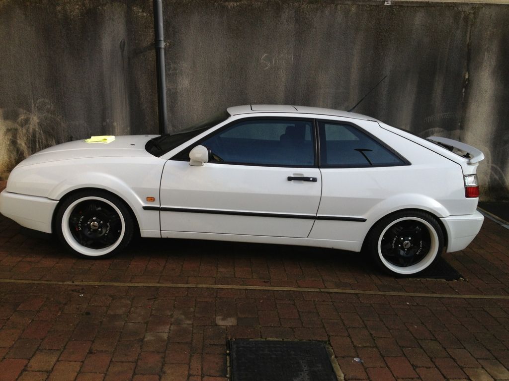

Well
FAR too COLD for full detail
And wax will NEVER cure in this temp (even with sun out)!

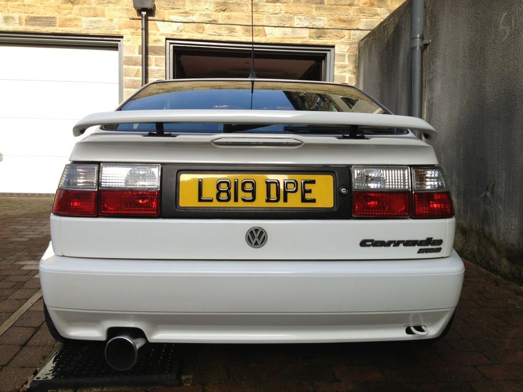

So QUICK detail:
Very shiny :)

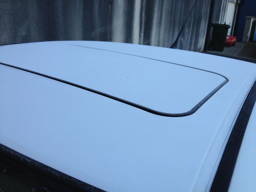

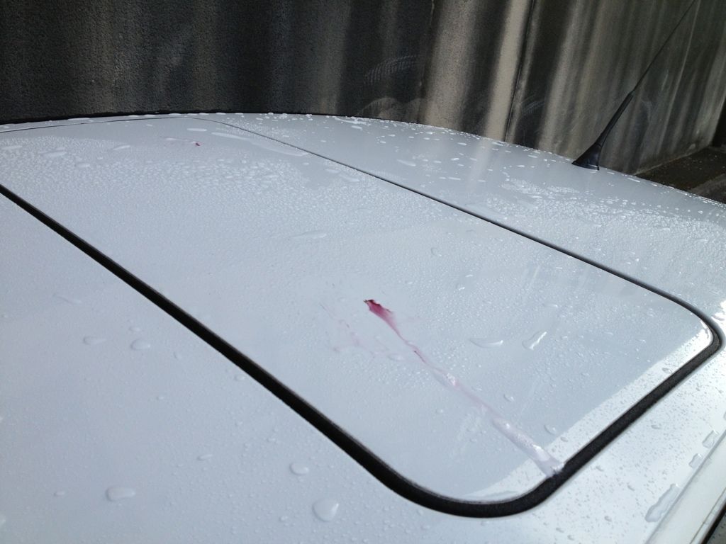

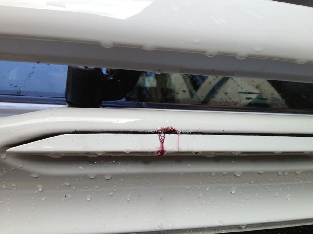

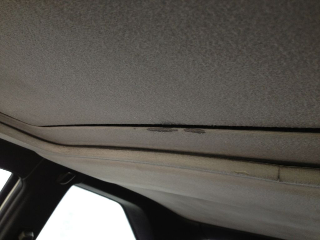

And after re-assurances from seller that there are no leaks on car and deffo NOT from sunroof nor boot -
i know these are NOTORIOUS issues/rust for old cars...i found:
YES!

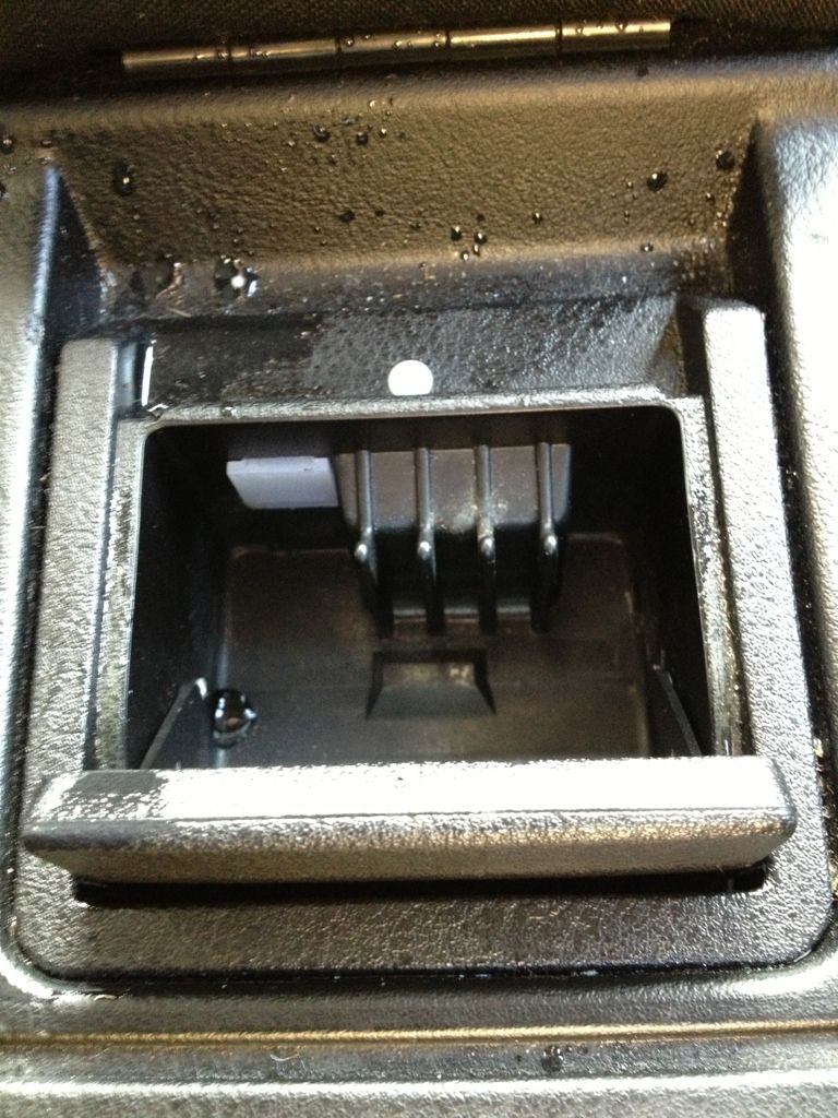

After one car wash - the back of sun roof LEAKS!
Inside wet from handbrake to rear ash tray!
Now unless the seller never drove in wet and always park in garage,
i am leaving me options open whether to return the car ...
Will give the seller benefit of doubt
But if i find major leak in boot as well then deffo considering the option!
GRRRRRRR

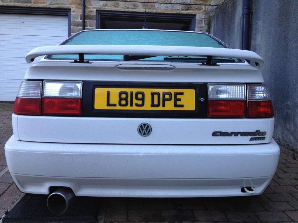

Looking good wayne! What sort of number plates have you got they look good! Was looking at getting some new ones for mine as there looking abit old.
Also it's a shame the guy you bought it from couldn't have been more honest about the car with you. Just proves what some people are like just to get a few extra quid in there pocket!
Atleast your managing to get on top of it all. Just a shame to keep finding more problems!
Cheers Tobz
The seller real nice guy - I will still give him benefit of the doubt.
Maybe I too nice!
Plate wise - no idea!
Came with car!
But they are embossed!
Not even sure they legal???!!!
So stayed behind a police van with camera today - just in case he decides to pull me over! Lol
Look like legal pressed plates. Available from Dubmeister I believe.
Cheers Sean!
But don't they also need name of supplier stamped on plates?
Just did a quick Google on plates.
It "seems" the law (include MOT):
Requires 2001 format plates PLUS BS standard lettering PLUS supplier details
BUT
Classic cars pre-1973 exempt!
And this is the grey area - what about cars made between 1973-2001???
Original plates maybe OK in pre-2001 format,
But I guess plates made from 2001 will have to be in new format.
So how does one/Police know if plates original?
Just looked on DVLA website guys! Aslong as your plates are correct font,spacing and letter sizing and are stamped on the bottom with a manufacturer watermark then it is fine! Also must be reflective witch makes sense.
https://www.gov.uk/displaying-number-plates/rules-number-plates
Will have to get on ebay and order some! So nothing to worry about with yours wayne haha!
Ref the leak, check the drains are working from the sunroof, the tubes could be blocked. Pour a little water in to the sunroof tray with the roof open to check it drains properly. The tubes can get blocked and the seal is just a weather seal, not mean to be fully waterproof.
