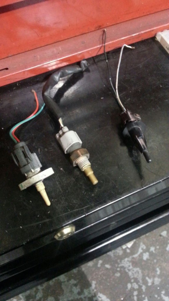

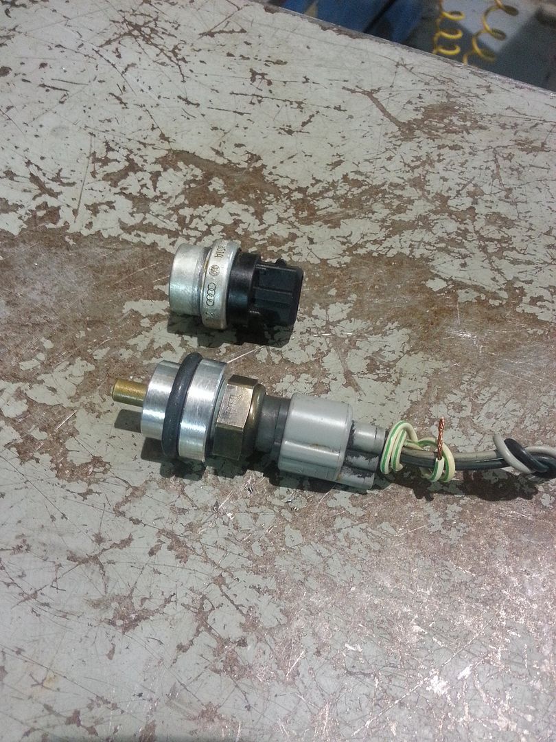

Went through a few water and air temp sensor's, testing them for resistance and to see if they were the right thing for my ecu's configuration. In the end i got one's that were close enough. Thank's to Chaffe for letting me into his drawer's. 😉

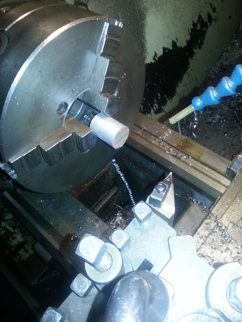

Machined an adaptor to fit my coolant temp sensor for the M-tech v4 ecu in place of the second stage rad fan sensor in the water housing.

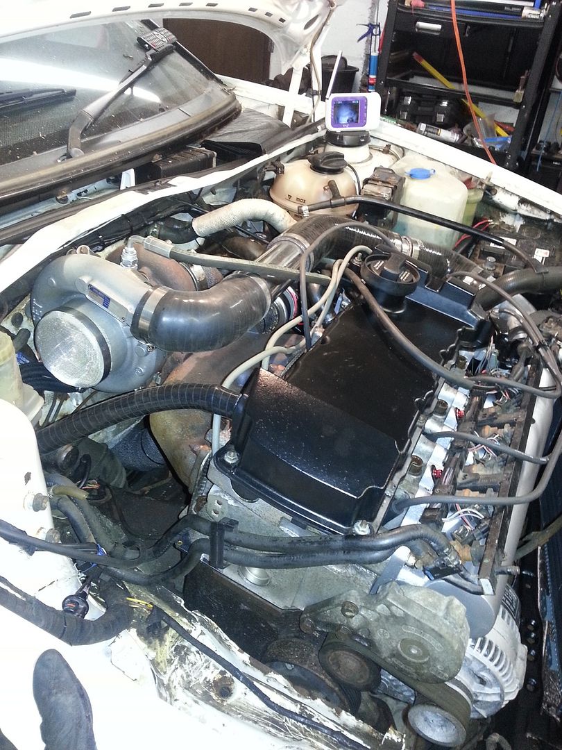

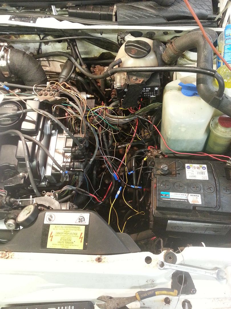

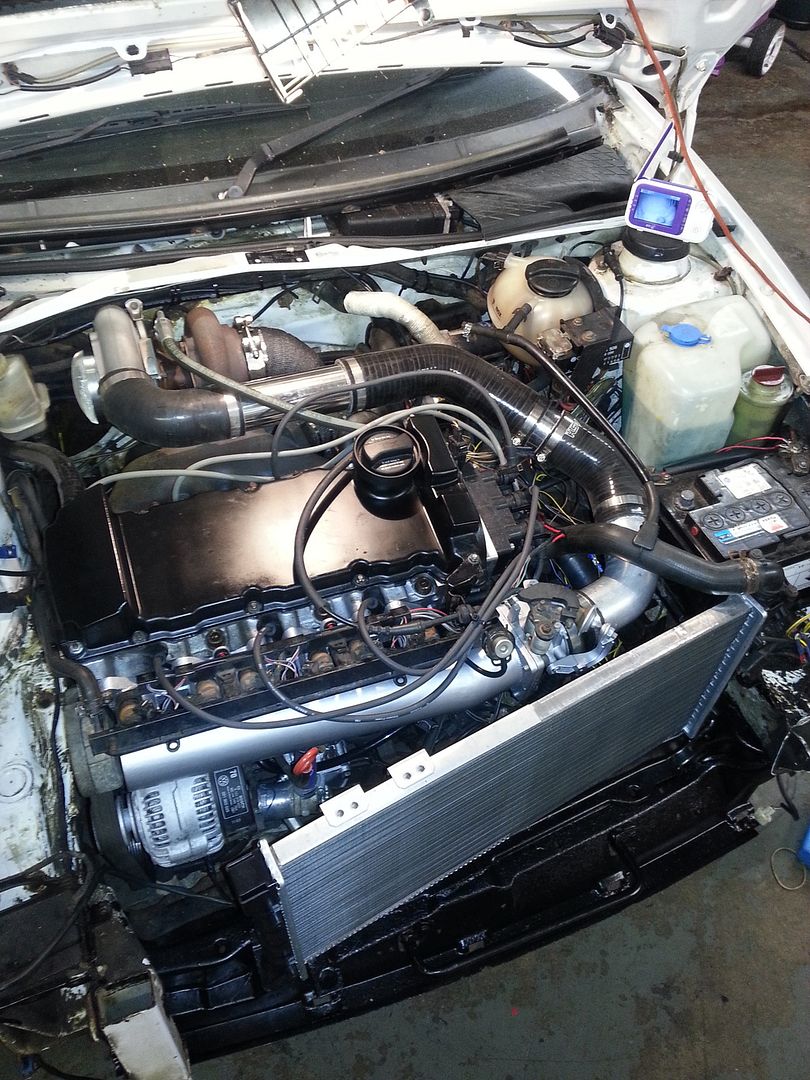

So basically this is the stage I'm at.
I'm still running standard injector's, standard fuel pump, standard clutch and I have no charge cooling. These are all thing's that I will obviously be upgrading, but for now i will try and map the car with what I have. My targets for the new year (after Christmas presents have been bought) are to firstly buy a set of injectors, as these will have an impact on the tune of the car, everything else will probably be installed when i have the fund's. Obviously I'll need some sort of charge cooling system before the boost can be increased, but as i do that I'll run out of fuel so I'll need an uprated fuel pump and then the clutch will start slipping and so on! Ha. Part of the fun I guess.

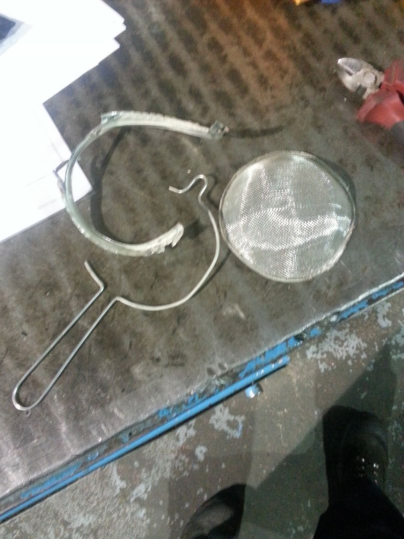

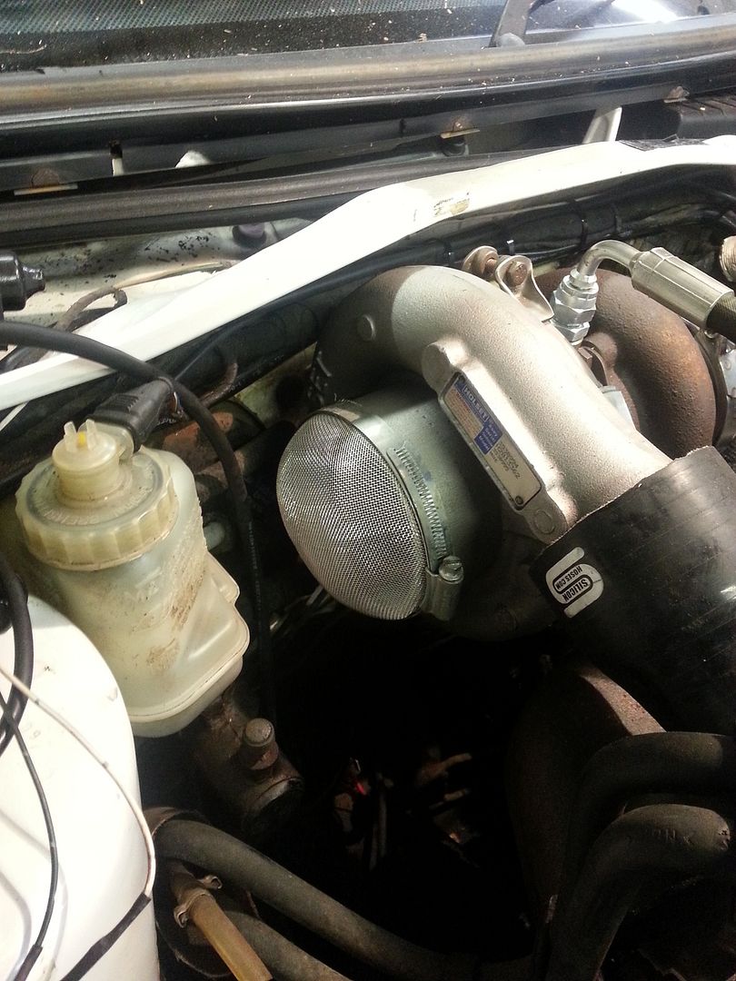

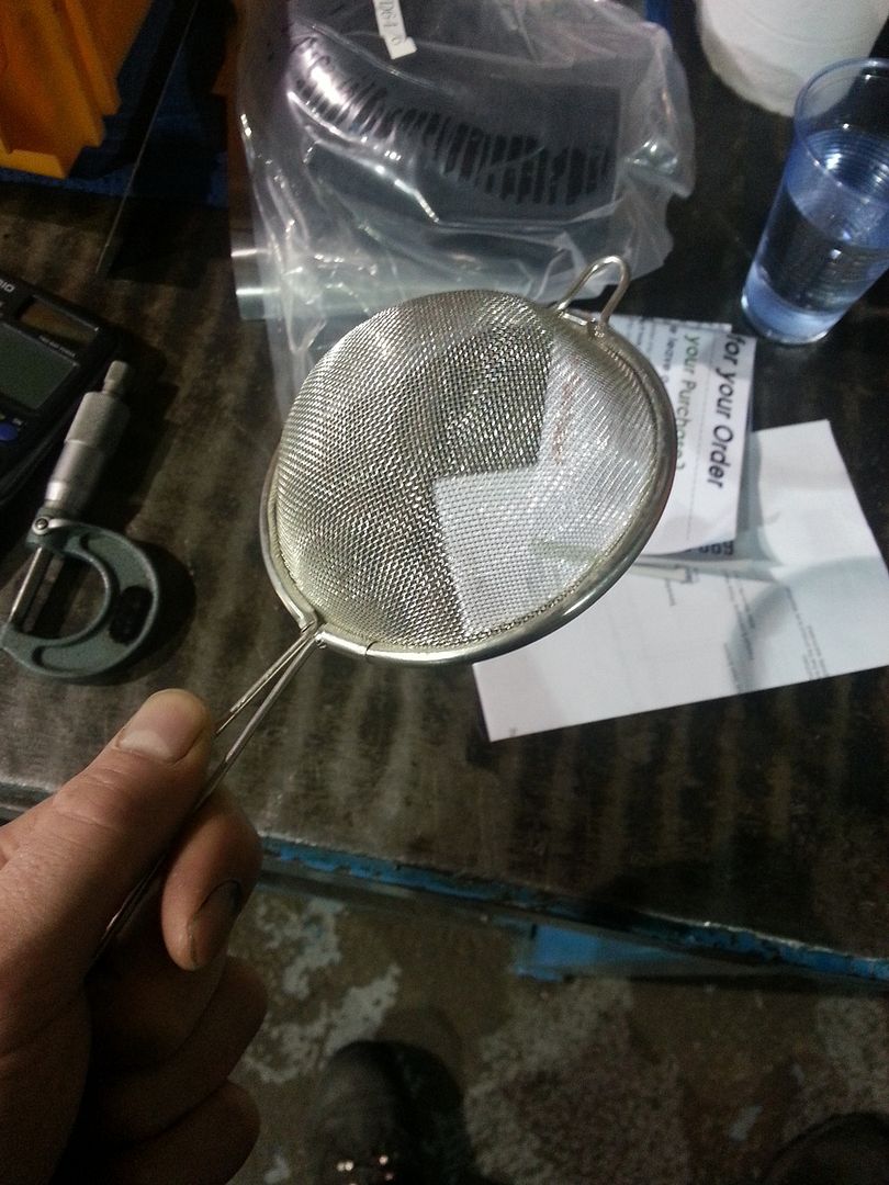

Stole the wife's sieve!

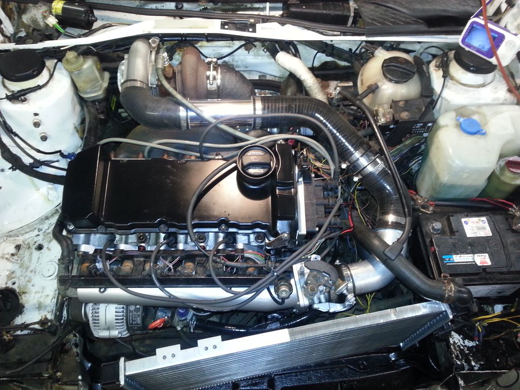

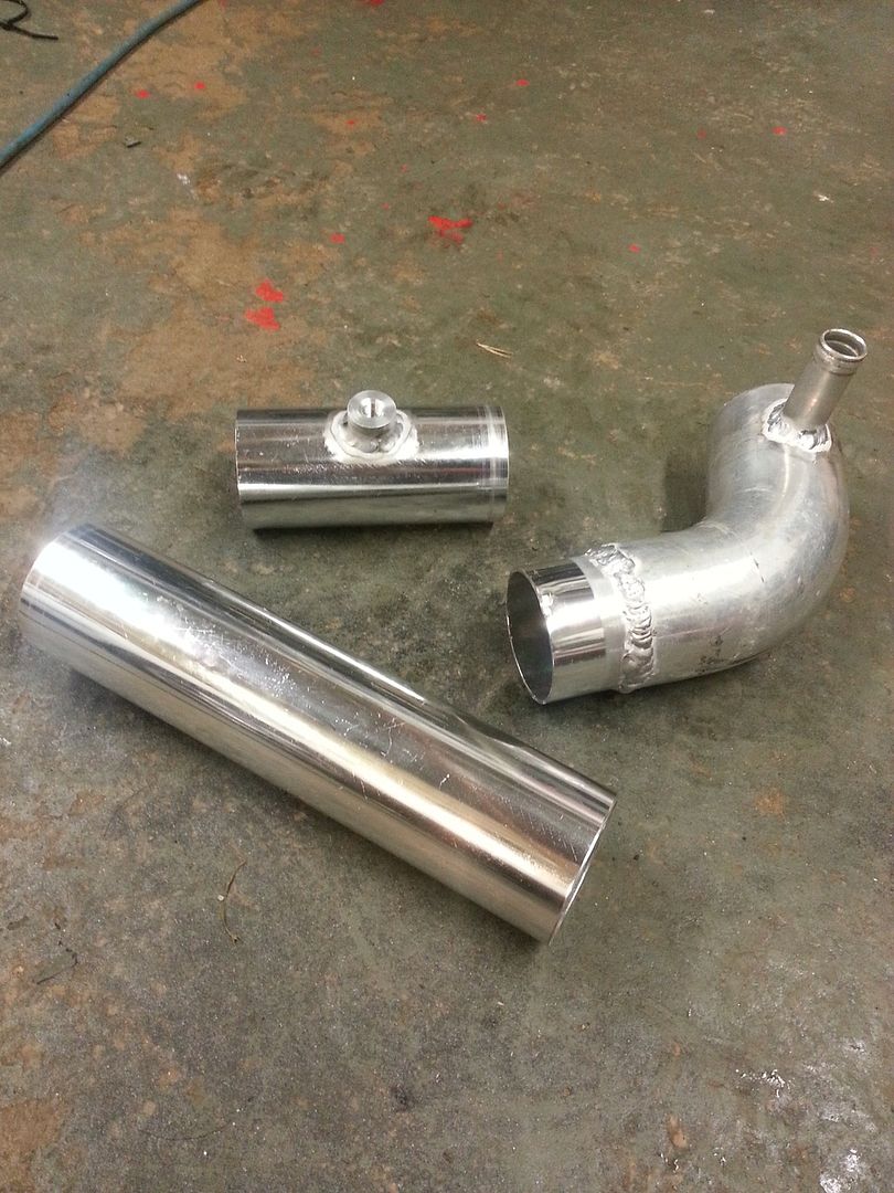

Made up some boost pipes to get me up the road.
