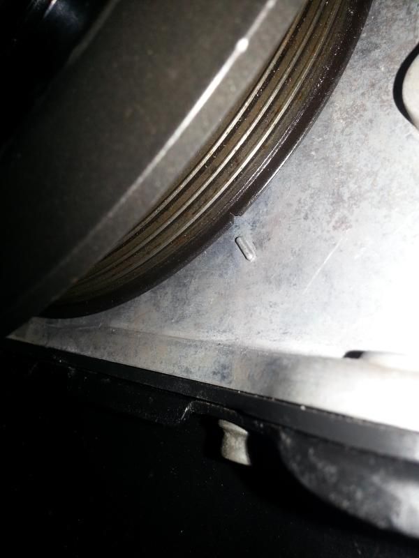

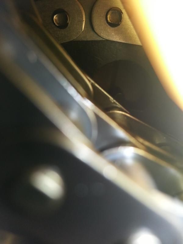

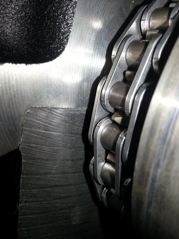

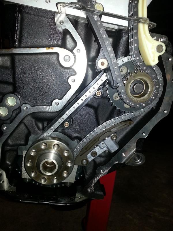

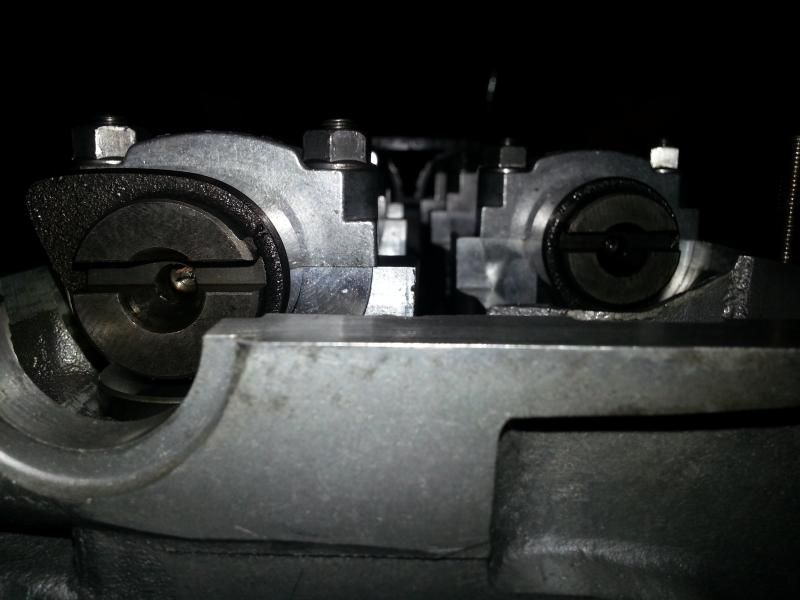

Jim Bowen 1 Posted April 13, 2015 Pics from when i did mine, Vince at Stealth talked me through it so i did what he said. On the crank gear (might not be the correct term), there is one tooth with the edge ground off, this should line up with the split in the casing. The flywheel will only fit one way, one the hole/bolts is offset to the others, you will notice it when you hold it up in front of you. The pulley on the other end should have a little notch to line up with a mark on the engine cover. The intermediate sprocket should line up to 12 o'clock position as Kev says, it was hard to get a good pic And then cams should look like this, one lobe is bigger than the others, the cam locking tool only fits in one way anyway Top chain slackness is on the right side so the tensioner takes it up. ^^Think thats quite hard to get wrong, its just a case of getting the chain onto each gear wheel tooth in the right place. I rested the intermediate sprocket in the chain and then fit it to the engine. you might have to reposition the intermediate sprocket on the chain a couple of times to get it right. Quote Share this post Link to post Share on other sites
