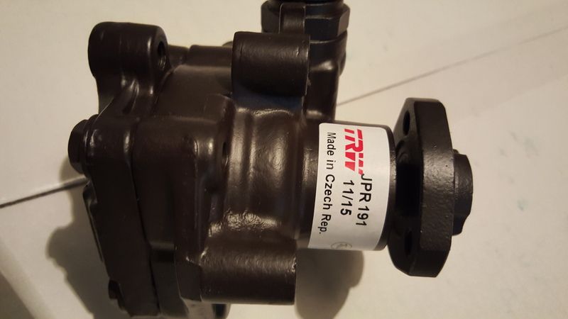

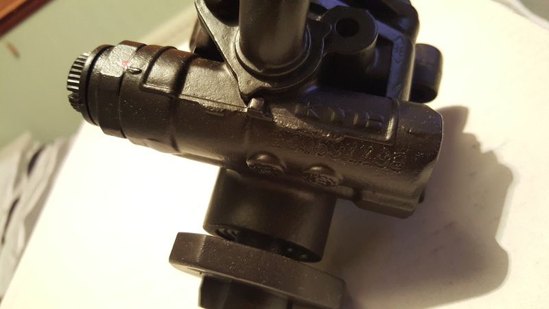

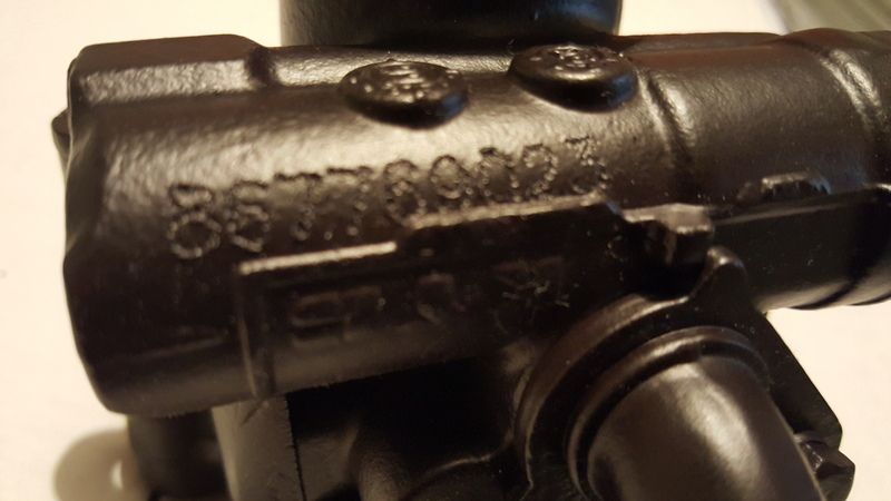

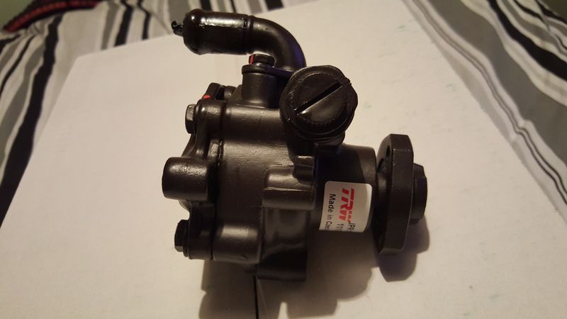

Jim Bowen 1 Posted March 23, 2016 Are there different versions for the VR6, its just the part i got looks quite different to the original, all the mounting points and pipe connections look in the correct place, not sure on the pulley alignment. Just been to VW and he mentioned the VR6 pump produces more pressure. Quote Share this post Link to post Share on other sites

Jim Bowen 1 Posted March 23, 2016 I have a couple of originals, the new ones says KYB on it, but then has a TRW label on it to say its remanufacturered. I shall get a photo of it before i fit it. EDIT: This is how the original looks https://iapunitedkingdom.com/catalog/product/view/id/165128 Quote Share this post Link to post Share on other sites
VEEDUBBED 0 Posted March 23, 2016 Yeah, both mine are original ZF, one on my engine and one off a Passat 2.9 ABV vr. Notice how the catalogue states 2.8 and not 2.9.. Might mean nowt but I wonder if the two were different. And check out that price, £200+ for remanufactured pump! New how much? Quote Share this post Link to post Share on other sites
Jim Bowen 1 Posted March 23, 2016 At VW its nearly £400 with the vat, although he said can do it for £250 if i bring old one in. The one i just bought was £215, but then got 20% off and £96 surcharge so ended up being an ok price. Quote Share this post Link to post Share on other sites
VW_OwneR_85 2 Posted March 23, 2016 (edited) i don't know if this helps anyone but after filling my system with the wrong fluid I had to change pumps and went with the one off the mk4 golf v6 4motion {as I had it laying around from the engine swap} , its clearly a bit different in terms of the body but connections are the same and on euro car parts the 4motions pump has the same part number as the corrado vr6's! {same pressure as well}, its been great! if you want a 2nd hand pump then one from the v6 4motion will be ideal, plenty about and newer... p.s totally forgot to mention , if you have red steering fluid then stick with the exact same part number pump that you got, if its green then you can go mk4 pump as they also run green, I did have red originally but flushed it out for green as that is what I was led to belive was right but its not!! the result is it whines once the steerings warmed up due the fluid being way thinner then the red stuff, so fitted the mk4 pump to get myself out of that problem Edited March 23, 2016 by VW_OwneR_85 Quote Share this post Link to post Share on other sites

Jim Bowen 1 Posted March 24, 2016 Veedubbed, thanks for the offer etc, but i know what the standard pump is like. More worried about the pump i've bought being wrong. Got some pics of it VROWNER85: interesting to know, mine has green fluid and has always been green. Going to look into the pump i have, i had a quick google and it was showing up as a golf pump. Quote Share this post Link to post Share on other sites
VEEDUBBED 0 Posted March 24, 2016 (edited) I tried but i can't get the thing to accept my phone, all it wants is computer downloads. what am i doing wrong? That pump looks quite different than my two i have on photo too, maybe just the colour that's confusing me. My pump's number is 357155C, ZF7691955117. 95Bar. Edited March 24, 2016 by VEEDUBBED Quote Share this post Link to post Share on other sites
