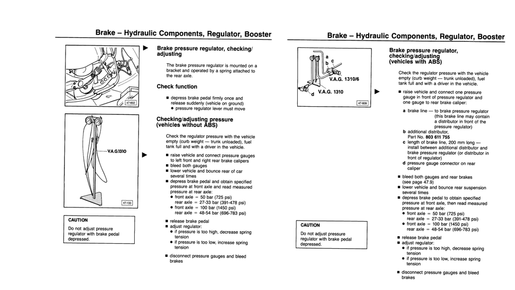

Does anyone have the specific specs on the front to rear brake ratio? I've fitted a new rear proportioning valve and I'd like to set it as accurately as possible using line gauges.
I've done a lot of searching and the closest info I could find suggests it's somewhere around 65% front to 35% rear.
Any definitive answers out there?

according to the Bently manual
Front axle = 50 bar
Rear axle = 27-33 bar
Front axle = 100 bar
Rear axle = 48 - 54 bar
Front axle = 50 bar
Thanks for the info.
So taking the centre value for the rears that works out at 62.5% front bias at 50 bar and 66.3% at 100 bar so 65/35 was about right.
I'll get adjusting 😊

I also found this link which gives the procedure for setting the regulator.
http://workshop-manuals.com/volkswagen/corrado/v6-2792cc_2.8l_dohc/brakes_and_traction_control/hydraulic_system_brakes/brake_pressure_regulator_-_load_compensator_rear_wheel_brakes/component_information/adjustments/
Time permitting, I'll give this a go at the weekend.
