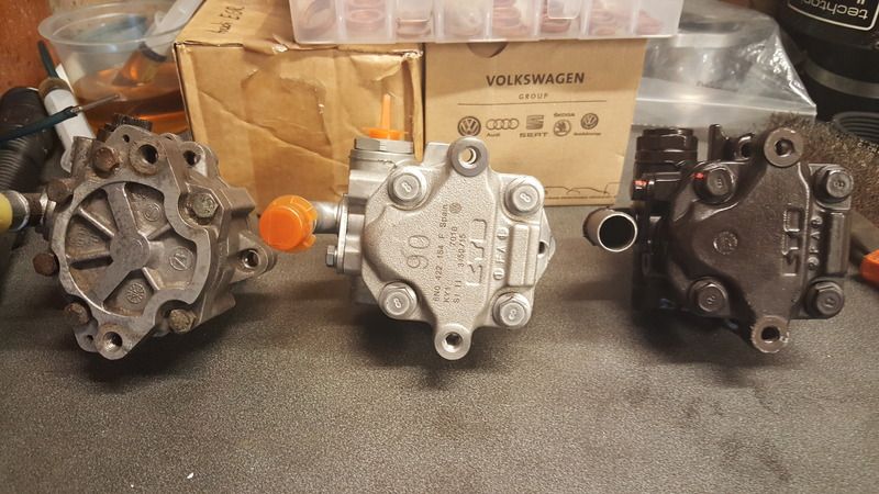

Jim Bowen 1 Posted May 24, 2017 Collected today. Took my original pump with me, despite it being stamped zf and 1994. Because the vw sticker had come off after 22yrs they wouldn't accept it as a vw part so i had to pay the £100 surcharge. The parts guy was really helpful, it was head office/parts returns that said no. He managed to help me by doing a discount on the pump, making it about £250 and then surcharge on top. Pump isn't the same as the original. Its KYB branded now, which is what i have on the car at the moment. Bought from gsf. Although the vw one looks alot nicer made. Quote Share this post Link to post Share on other sites
Jim Bowen 1 Posted May 24, 2017 Fitted it this evening but haven't started car to see if the noise has gone. Was no noise from the pump i took off when spinning by hand, but felt stiffer than the one vw supplied. Worked out the kyb one from gsf has only done a hundred miles or so. Quote Share this post Link to post Share on other sites

Jim Bowen 1 Posted May 25, 2017 Well it sorted the problem, did about 40miles this evening and no noise. Quote Share this post Link to post Share on other sites
Jim Bowen 1 Posted May 25, 2017 The pumps. Original on left, VW supplied in middle, gsf supplied on right. Quote Share this post Link to post Share on other sites
