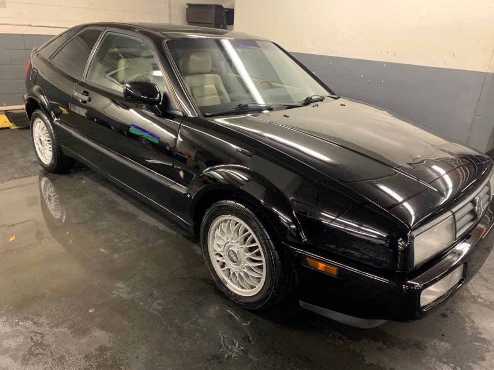

I have a 92 SLC and it seems the headlight switch on the dash will not fully press into position causing only the driving lights to come on and not the headlights.  Does anyone know how to replace that switch?
Thanks!
Just pop it out. Easily done.
It pulls towards you. Or get your hand up underneath and push it out.
Then disconnect the wiring plug
