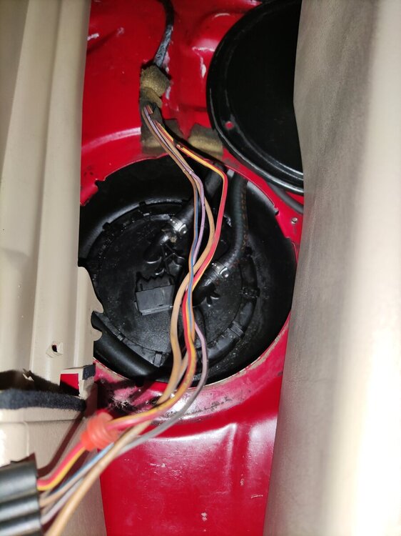

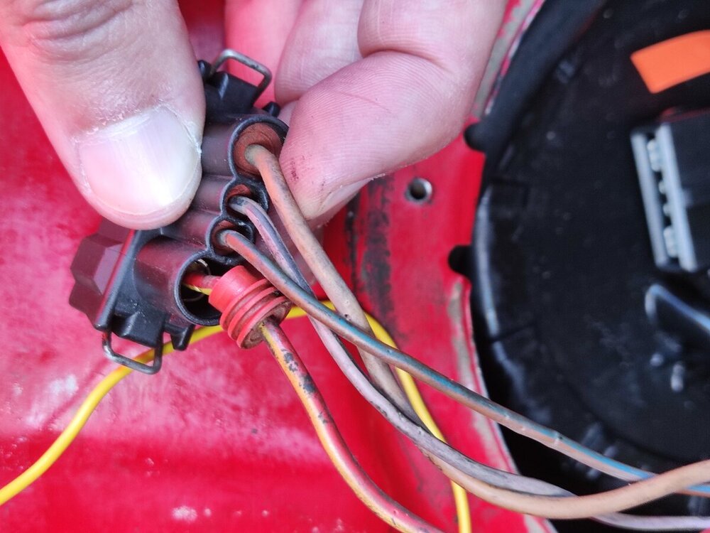

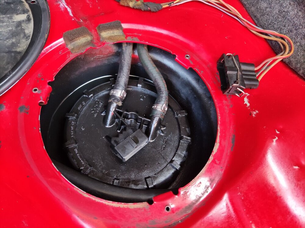

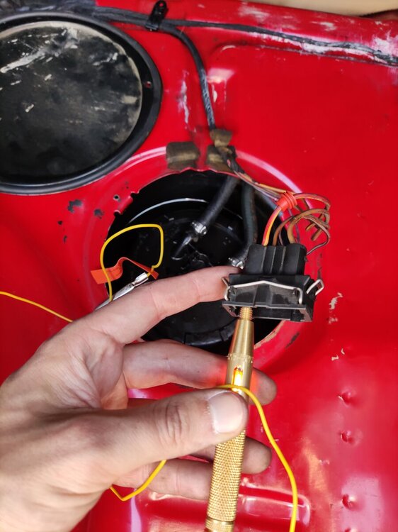

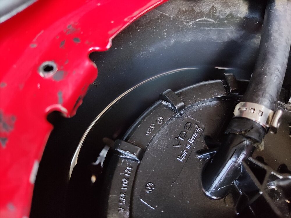

Again: Fuel system electric issues. New relay but fail again.
I don't know what caused ECU blown, because after I did checkings, I saw a lot of possible issues (crappy car alarm installation, dirty grounds or bad grounds, fuel loss...). But the car stops in uphill street, where the fuel that remains near the fuel pump connector, I think it made contact with connector, ground, etc. I don't know if it can blown a ECU, but there was a lot of fuel near the connector when the car stops.
You should not have any fuel hanging about on top of fuel pump, have you checked all the rubber seals when you installed fuel pump and make sure your feed and return lines are not leaking as well.
And make sure the insulation of the pump wires are all good.
