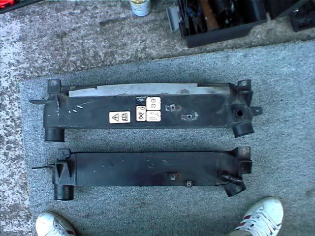

I'm looking to fit an intercooler that's 66cm long & 12.25cm thick behind the grill, here -
(will relocate the horns)
(sorry for pic size)
download.php?id=9044
Question is, will it fit? Not had time to measure.
it's the bigger one.
11.5 cm high (top to bottom)
66cm long to its furthest opposing points
12.25cm deep (front to back)
45.5cm actual core length.
Cheers
Dan

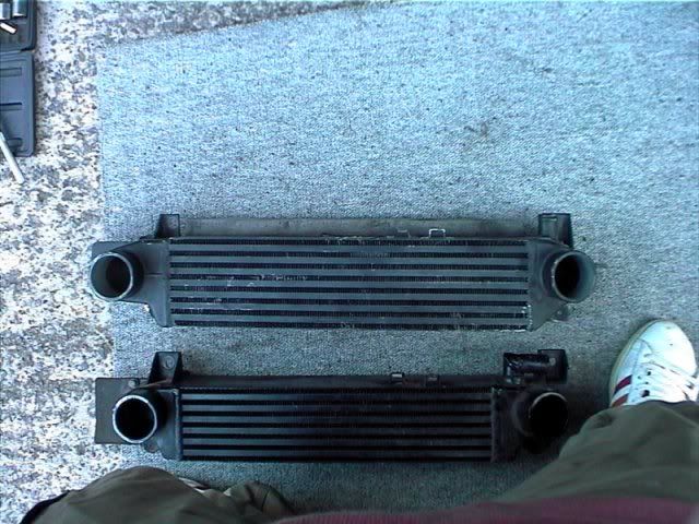

I made up a template last night. The 4x4 cossie (the bigger) one isn't going to fit in front of the rad. My I think I'll buy a 2wd cossie (the smaller) one and use that. They are good coolers, a lot of the RST boys put them on their RS's. If these do fit, it would prove a relatively cheap upgrade for those with a G60, as these coolers are quite common, so don't cost much!
Not sure,
here are the measurements:
2wd:
10 cm high (top to bottom)
60cm long to its furthest opposing points
10cm deep (front to back)
41cm actual core length.
It does have a bigger surface area though, and will also be in a better position for cooling, so has to be an improvement over std.

the cossie ones dont fit well in the corrado front. if i were you and u want to use somthing from another vechicle i wouls go for a renualt traffic / vahxual movano intercooler, these fit in nicely one the headers are modded the flow very nice too.
