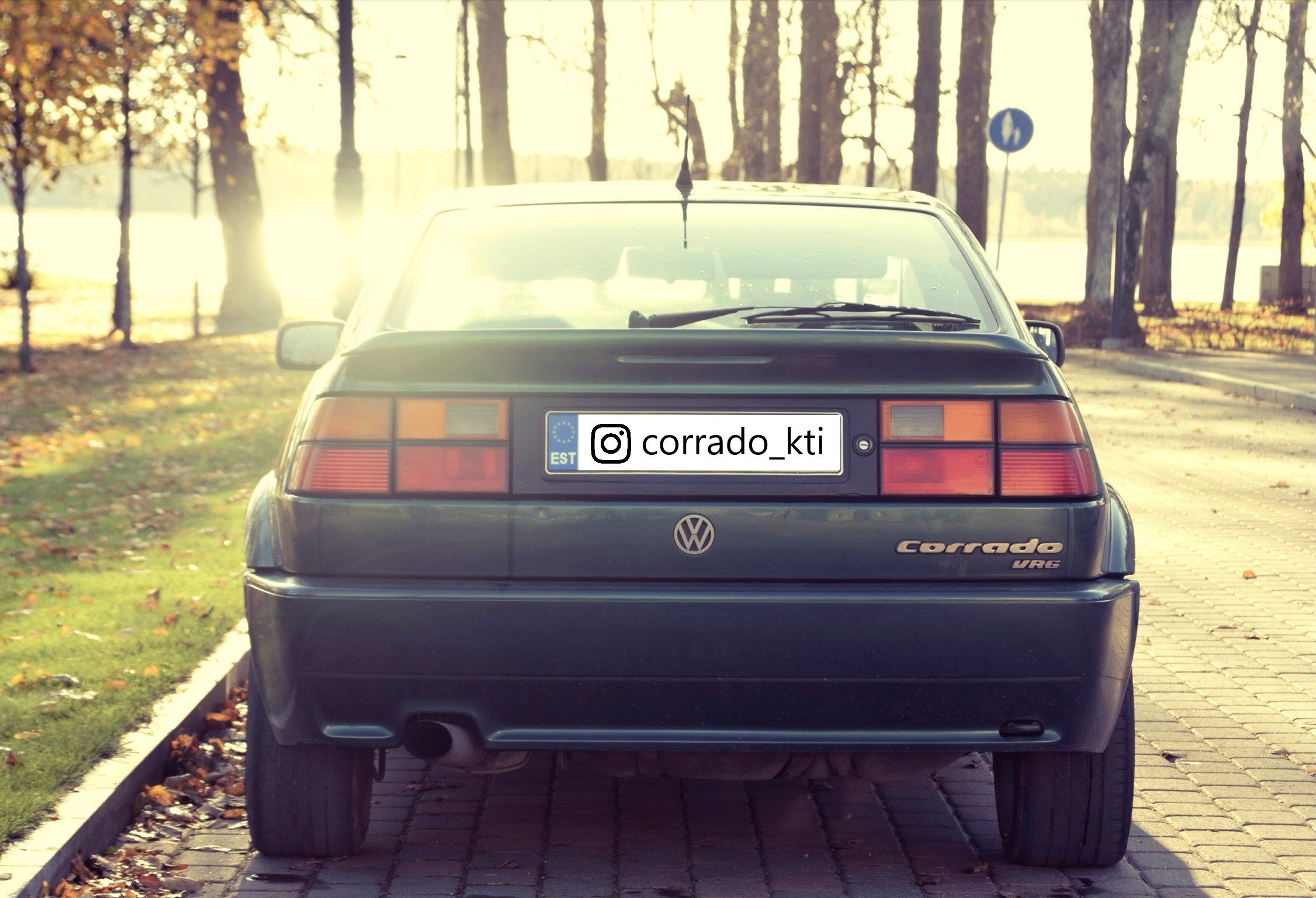

  2. So.. the car is ready..ish. πŸ˜„ Well the first vision has basically come to life. Motor is done, car is back on streets (since 19th of May actually already). Since then I have been trying to find the right wheels and tires and fitment. And today I can say, I'm happy with the results. Firstly I had 17"8J ET35 JR23 wheels. Then I had to put spacers, front 10mm because of the brake caliper. At first I wanted to put 15mm to back, but couldn't, because um.. it didn't reach the wheel hub (?).. well, the wheel was loose. So the solution was 20mm spacer, which actually was perfect. As for the tires, firstly I got 225/35, but knew right away that I couldn't lower the car, when the coilovers arrive. So bought coilovers (MTS-Technik), went back to my originals 16" and lowered the car. Then ordered new tires, 195/45. Today got them assembled to JR wheels. In the front it has a little camber and I can't let it more lower. Perfect would be I think 195/35 tires, but I'm done with the wheel problems for this year πŸ˜„. But /35 stretch would be still nice (I don't like over the top stretch) and can go lower or stay as low without any problems. Personally I think in the future I would get 16" wheels, all 8J or back 8,5" and front 8". ET...I don't even know, it seems to me it depends on the wheel itself. But I don't mind using the spacers. So now I have to deal with details. Bonnet lining, front lip (the thin one), passenger door handle, left window scraper, sound system and many more details to search and buy. πŸ˜„ The engine bay is quite awesome, the polished manifold and the plastic covers which actually sparkles in the sun. It really isn't as clean as in the picture, since the engine bay didn't get new paint and all the hoses and wiring are old - not so shiny. But I'm happy, big work has been done and I could to so much of it by myself - quite proud. 😊
