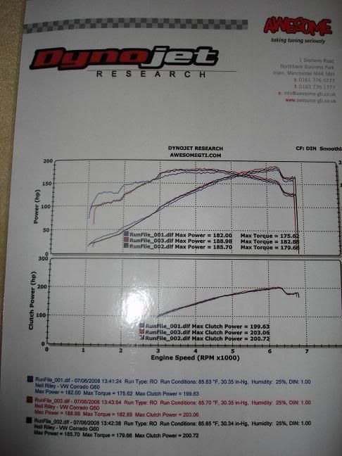

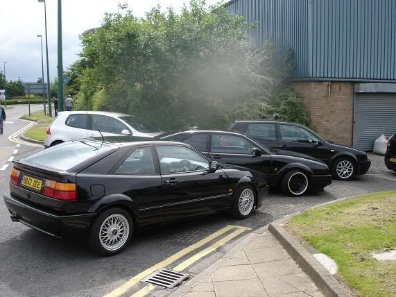

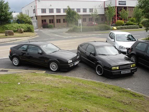

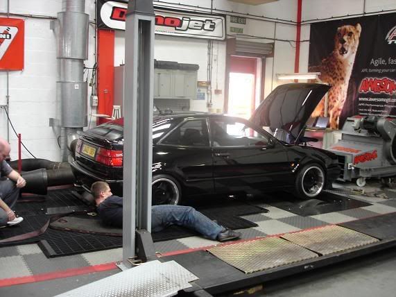

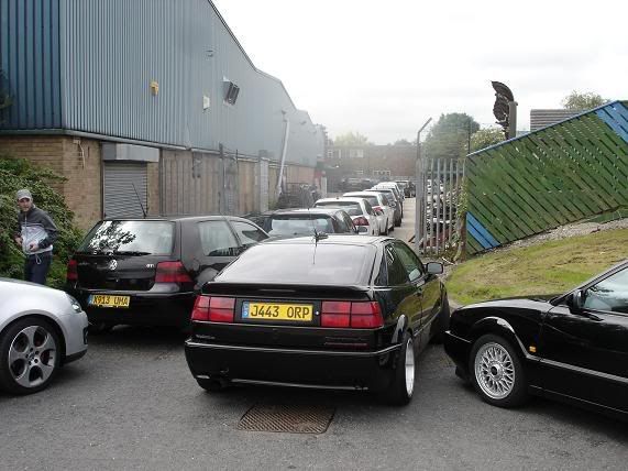

Riley 0 Posted June 8, 2008 Nah problem still there... :( Went to a rolling road day at Awesome yesterday...A few of us went and it was a good do :) Thought i may as well find out what the corrado is putting out, here's a couple pics first. Me and Joe, the only Corrado's there waiting to get on the rollers. And onto the rollers being strapped down, i asked them not to strap it through the wheels :oops: so they were there messing about for a while! I was getting worried at this point... And the figures/graph. 203.6 brake horse and 184lbs ft of torque, i don't know if this is a good result, but im very happy with the way it puts the power down (bottom graph) And this is with my 3 year+ running problem! Clicky here for video. Neil. Quote Share this post Link to post Share on other sites

dirtytorque 0 Posted June 9, 2008 can't argue with those figures mate :0) :salute: I rekon u should get a wideband of some description so you can see what the fueling is doing. It might point you in the right direction in relation to you know what. :) Quote Share this post Link to post Share on other sites

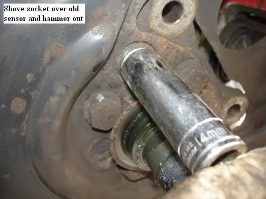

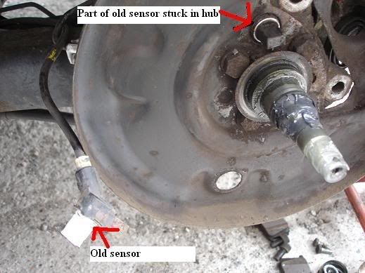

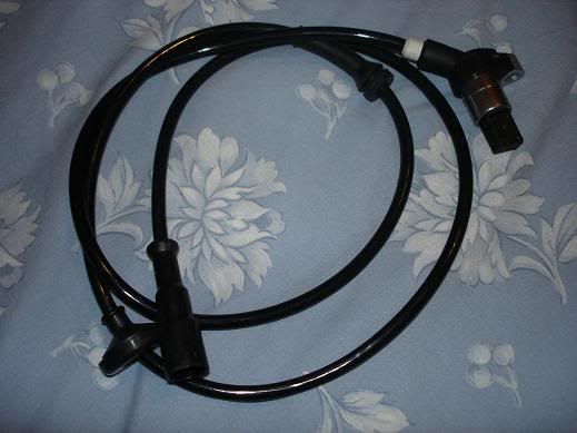

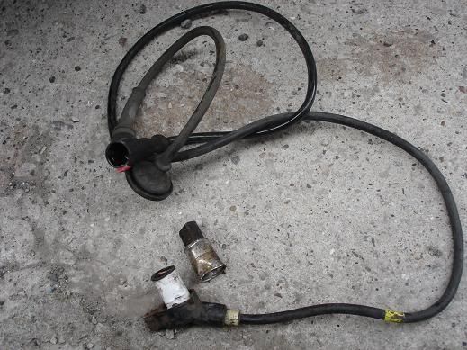

Riley 0 Posted June 17, 2008 Finally found a reasonably priced rear abs sensor for the rear left! Nice new one: Old one broke upon trying to remove (common) so the sensor/magnet bit was stuck tight in the hub, a little tip is to place a 13/14mm socket over it and knock it out...just means removing the caliper/carrier/disc. And if you don't at least have some emory paper or ideally a small finger file you will never get the new sensor in...You have to clean the hole back to absolute bare metal, and then apply a small amount of copper grease. And removed...No abs light blinding me anymore :D Neil. Quote Share this post Link to post Share on other sites
was8v 0 Posted June 18, 2008 Where did you get the sensor from? Cheers. Quote Share this post Link to post Share on other sites
dirtytorque 0 Posted June 18, 2008 No worries Manny 8) Aye, may look into the wideband jobbie...just need to understand them a bit more first as i like to learn before buying sommet blind so to speak. The corrado is now up on Awesome gti's site too :D Piccy here Rolling road graph Video? Also check here for Joe's g60 corrado, and Manny's mk2 g60... Neil. get them to see how it fuels at your next MOT. :salute: nothing wrong with it in terms of making power though. :) Quote Share this post Link to post Share on other sites
CTWG60 0 Posted June 23, 2008 Me and Joe, the only Corrado's there waiting to get on the rollers. And the figures/graph. 203.6 brake horse and 184lbs ft of torque, i don't know if this is a good result, but im very happy with the way it puts the power down (bottom graph) And this is with my 3 year+ running problem! Neil. Good numbers, is joes standard as there is no spec next to his image on the website.I assume joe's is the one with the early grill in black with BBS's? Wish I'd known about this I would of tagged along need to my car back on the Awesome rollers to see if I've fixed the fueling issue I had last year. Oh well! :| Your looking at around 200lb/ft at the flywheel from what I can workout. :) If you know of any other days at awesome before Spetember/October time please let me know. :) Quote Share this post Link to post Share on other sites
Riley 0 Posted June 23, 2008 Hi mate, aye i guess the figures are alright...And yep Joe's is the standard one, just lowered on the original bbs. :) We are starting to organise a day at awesome on Volksdevil here and here. :) Where did you get the sensor from? Cheers. Good ol' ebay mate :) there's a guy finally started selling them on there. 8) get them to see how it fuels at your next MOT. :salute: nothing wrong with it in terms of making power though. :) Cheers mate, it fuels spot on at mot :( Quote Share this post Link to post Share on other sites
