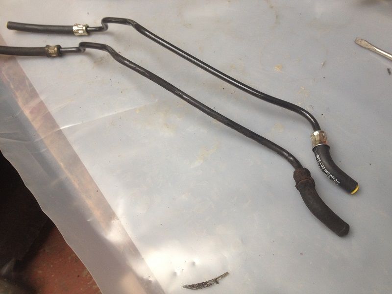

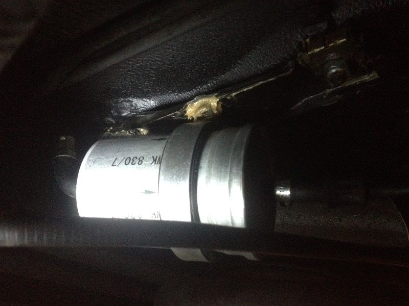

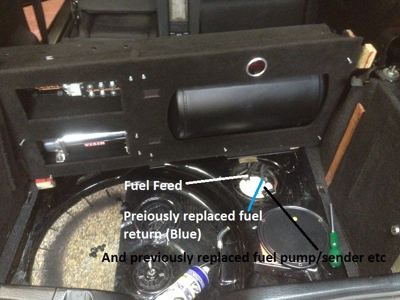

Next came replacing the fuel line from the tank to the filter...Ball ache of a job. :bonk:
Fuel tank needs dropping as far as you can, and unbolting from the filler neck area. At least got a good look at the bodywork up in behind the fuel filler. Solid as a rock, so threw a load of wayoyl in there too.

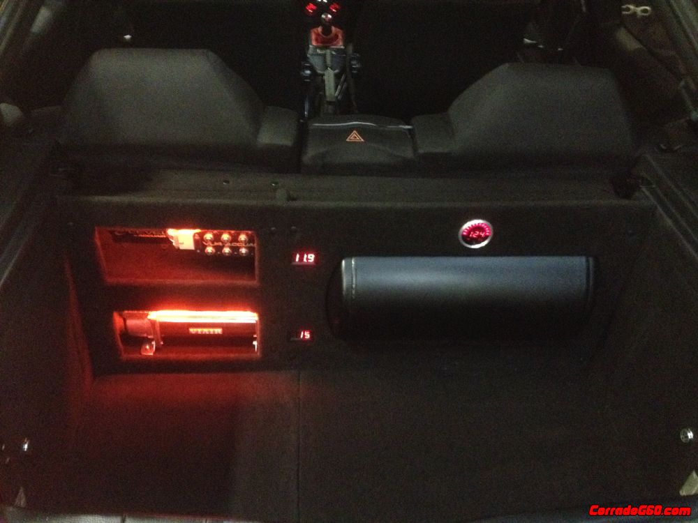

Oh...And I had to half dismantle the air ride boot build to get at the top of the fuel pump. :shrug:

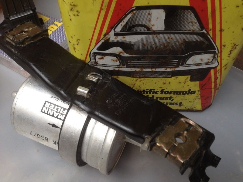

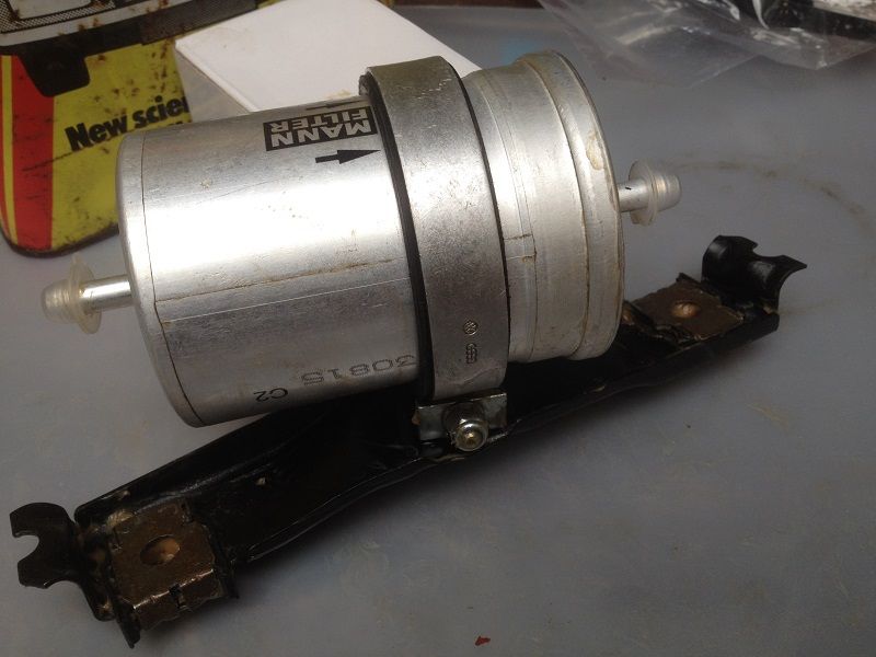

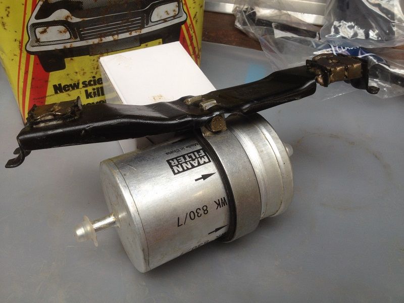

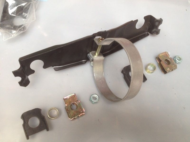

And some pics of the fuel filter bracket parts all built up. Slightly over engineered part for holding a bloody fuel filter Vw!

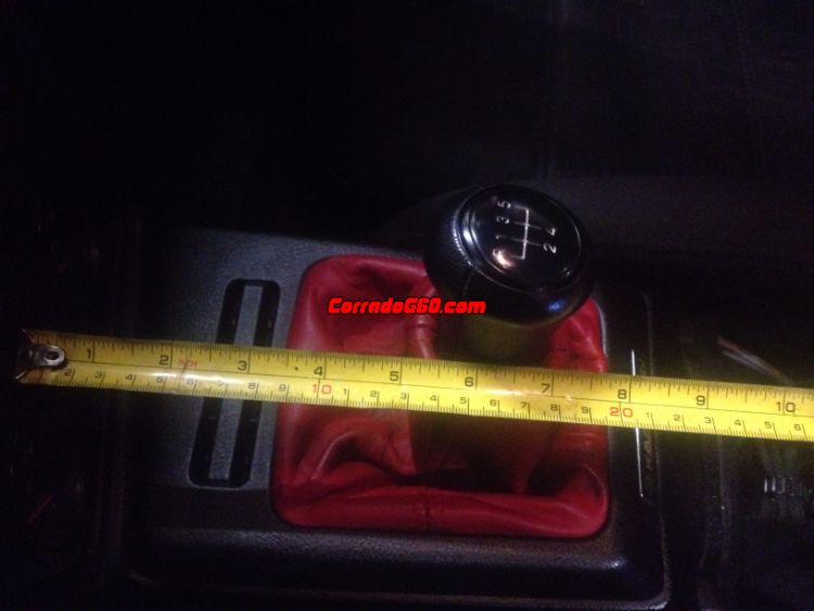

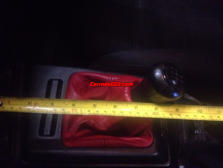

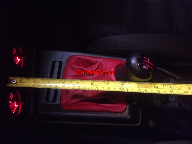

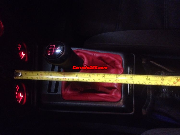

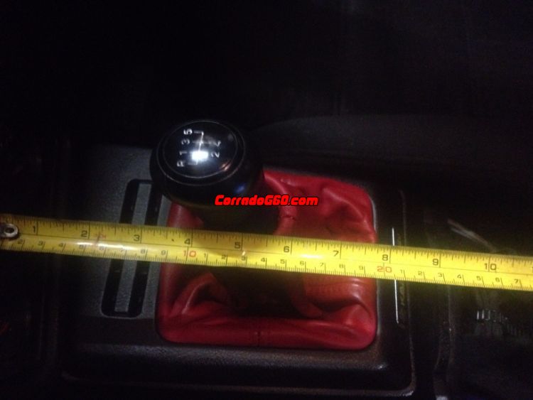

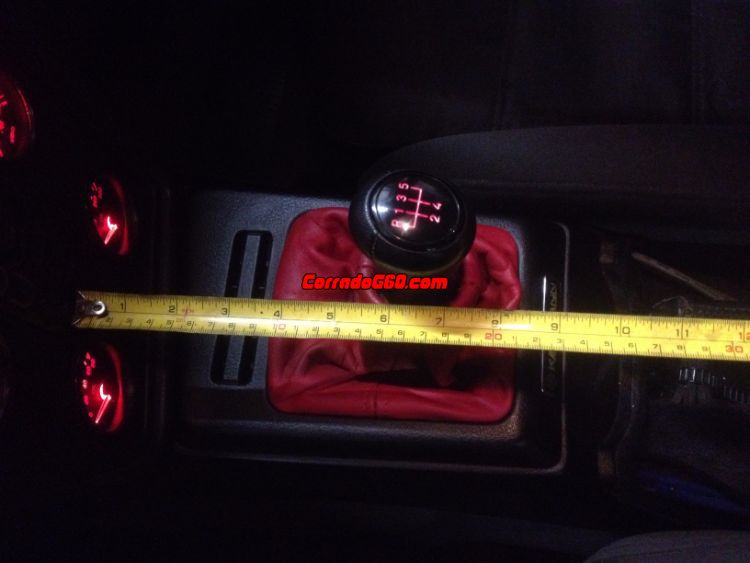

Short shift fitted, better but I may decrease the forward/back even more as it still feels like too much in the Corrado after driving the IS200.
Also put a guide together - Corrado Short Shift Fitting Guide.
I replaced all the bushes in the gear lever as well, will add a guide on how to do that here later.
Before: 5" of movement.
After: 3.5" of movement.

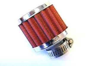

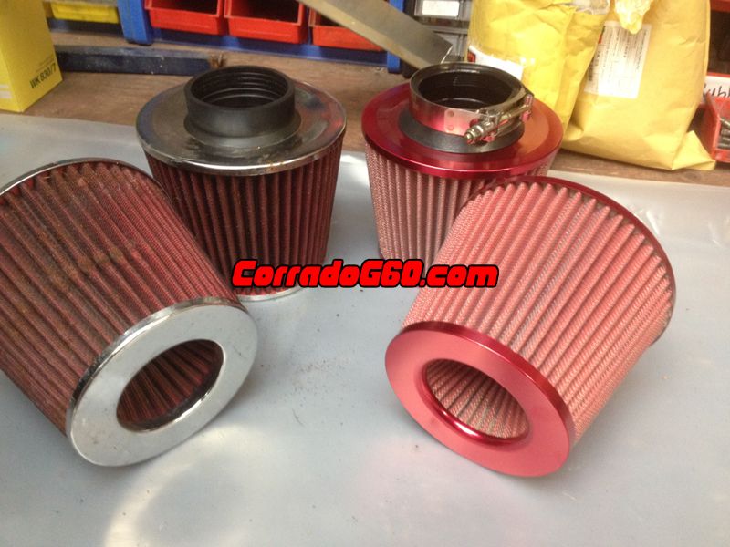

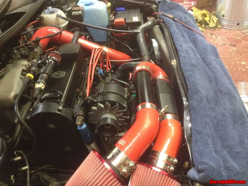

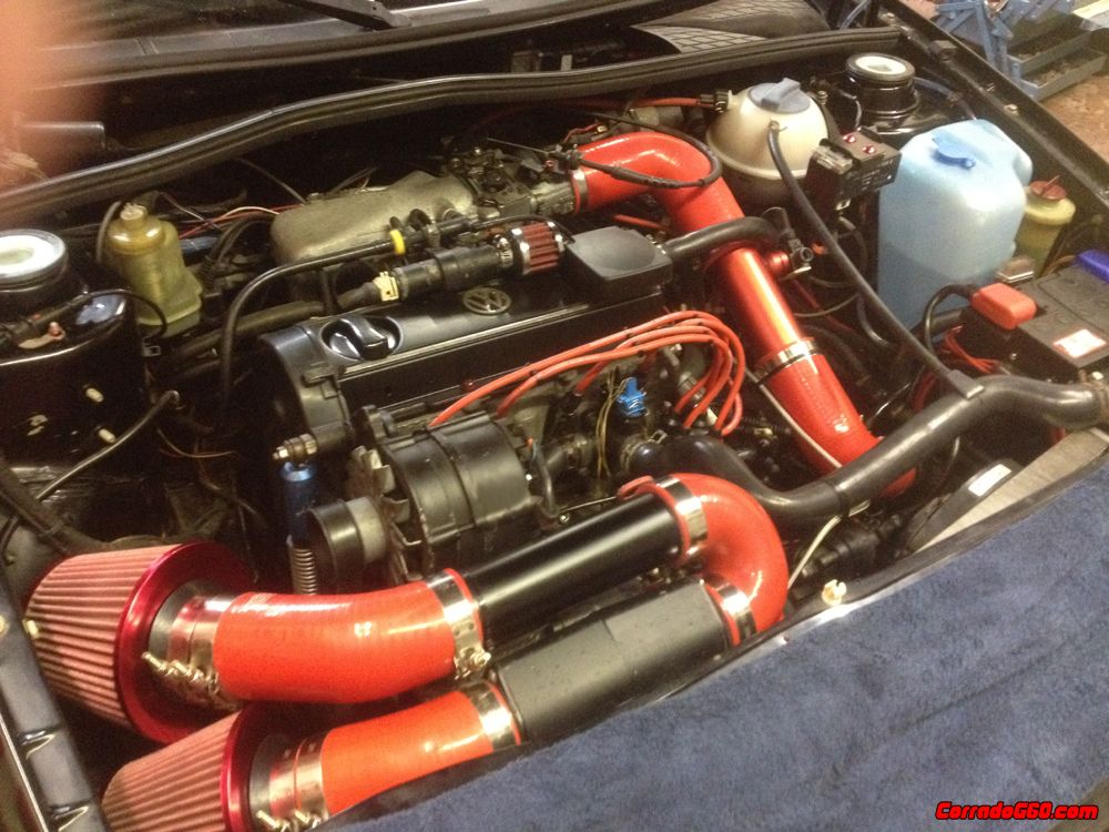

The old air filters were looking a bit crappy so went for some new ones, thought I'd try some with red metal parts rather than chrome effect this time.

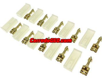

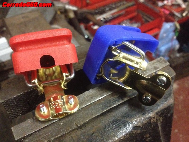

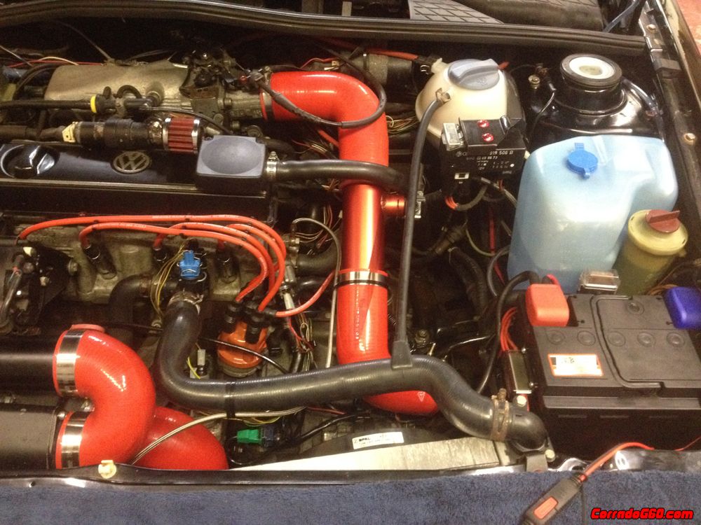

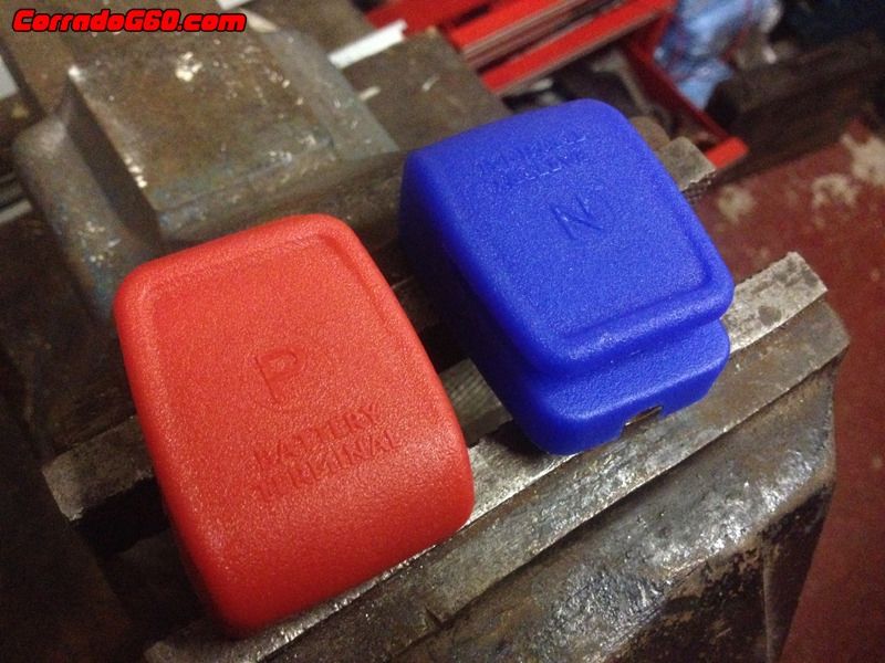

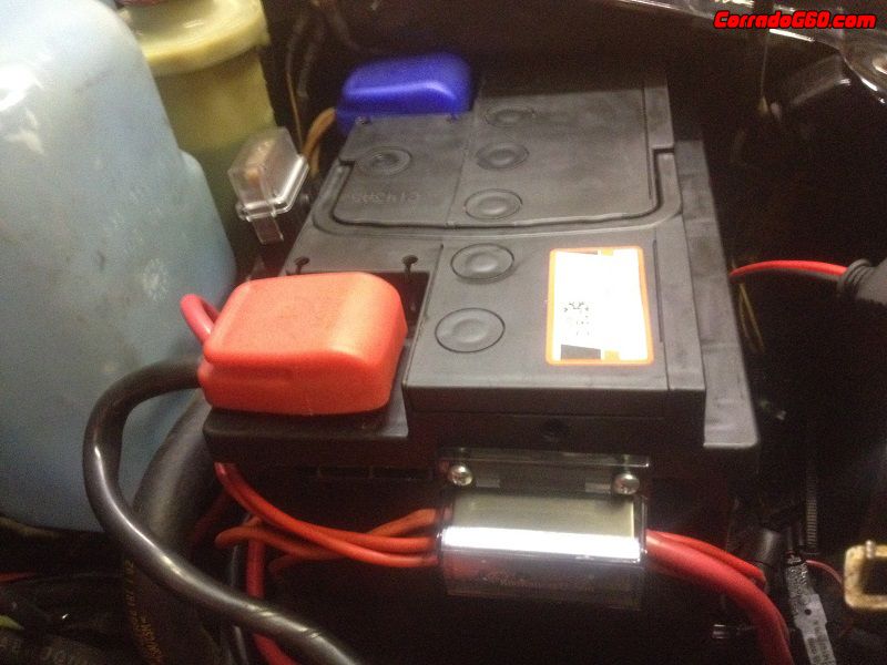

Bought some quick release battery terminals...

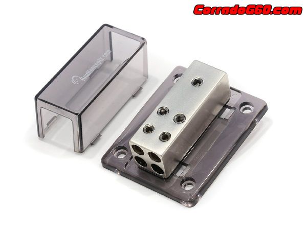

Had to but a power block so that I could run some of the positive battery wiring away from the battery terminal...While wanting to keep the starter motor cable fitted directly to the battery.
It's OK for now but want to find something more waterproof ideally.
New ISV filter too. Old one lasted well.

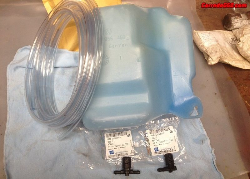

Removed the windscreen washer bottle and took it home to clean it out. Can't find a new oe blue one anywhere man :-(
Also picked up some new hose for the washer jets.
And obviously to do a little modding too...

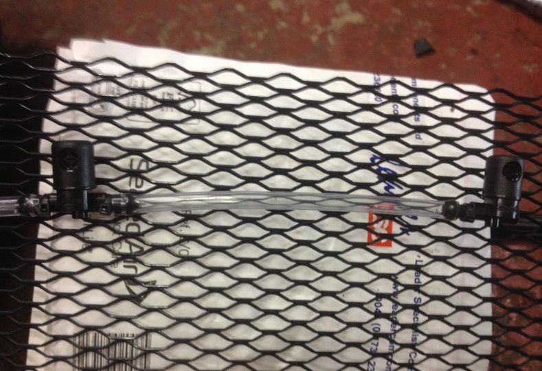

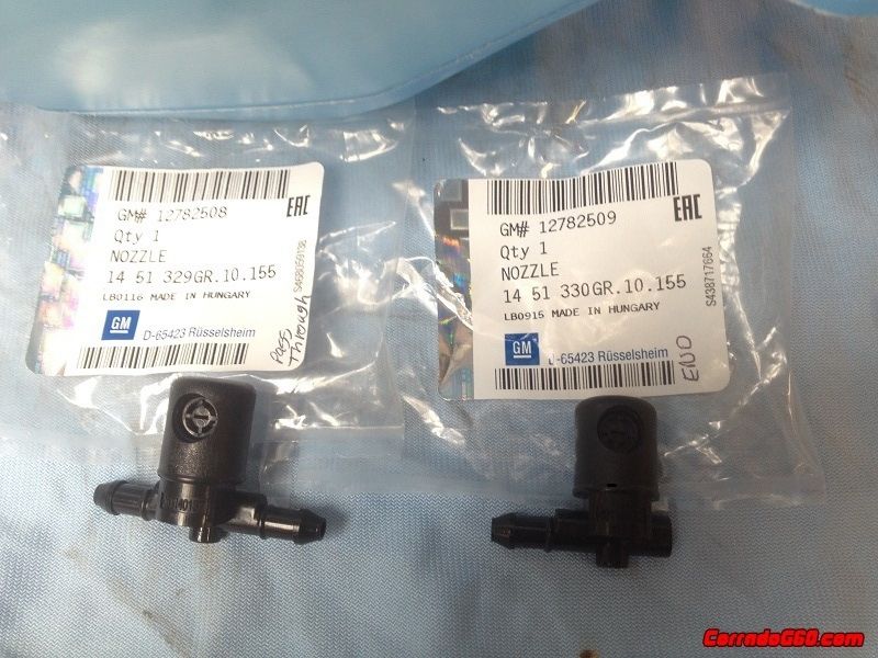

I bought some vauxhall 'misting' windscreen washer jets.
And fitted them to the inside of the mesh in the bumper. I simply ran some new hose from the original rear wiper outlet on the washer pump. So whenever I operate the rear wiper, the cossie intercooler gets a nice misting! May wire up to a switch on the throttle body to operate under full throttle instead...

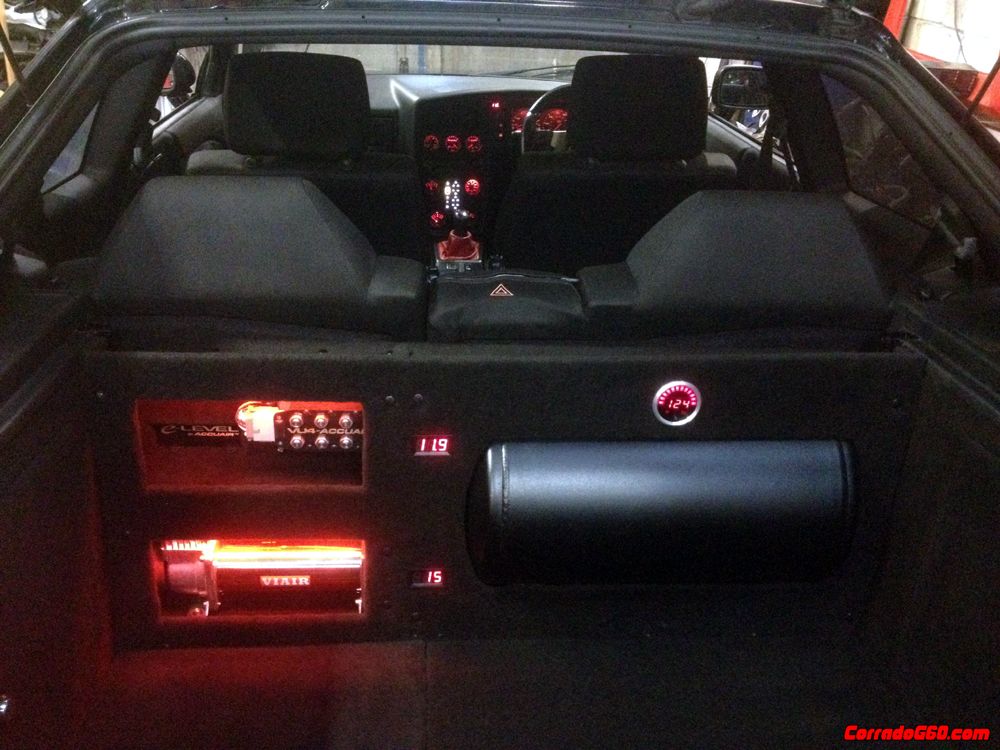

Got the air ride boot build back together, and went through a test of everything electrical ready for an MOT at some stage.
