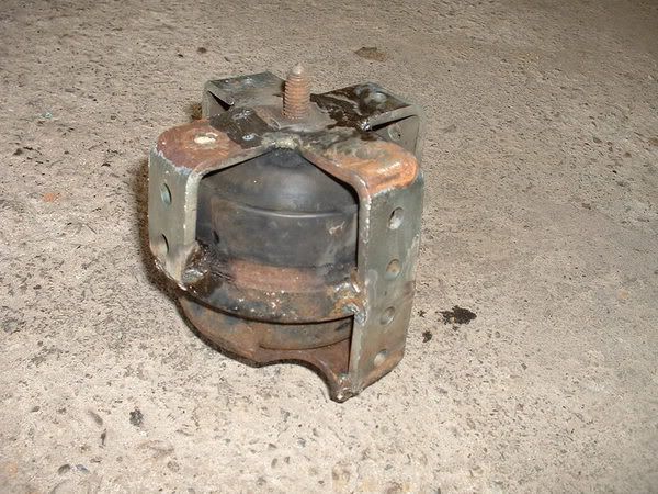

sambo 0 Posted May 19, 2005 This is what i did last time my mount broke! :lol: I know it aint prety but it does as good of a job as a VT and it cost me half hr of my free time! Quote Share this post Link to post Share on other sites
NickVR6 0 Posted May 19, 2005 Sweet motor Sambo, first time of seen it on here mate. I have no welder though, and if i did i'd be dangerous! Looks like an easy upgrade route though. Trying to think who i know! Am pretty much set on the vt, but i have about 5 things varying between £120 and £400 each that i really need to do and everything im doing for the next 3-4 months is all gona be on the old credit card, so i am going to have to be sensible at some point..............mmm Quote Share this post Link to post Share on other sites
