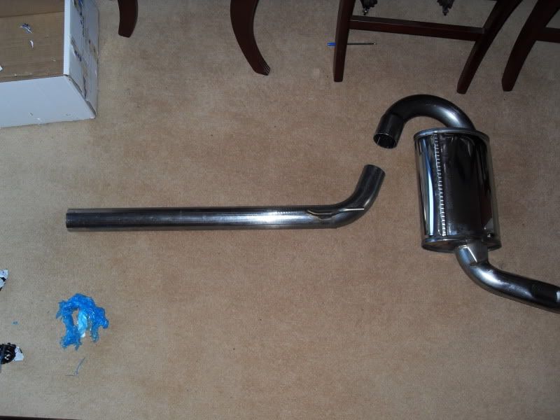

Timbo 0 Posted August 19, 2009 Keep us updated about which one you end up choosing...... I eventually went with the Supersprint in the end. It generally seems very high quality, and the exhaust tip nicely suits the cut out in the bumper; much better than the OEM one anyway. Unfortunately Supersprint no longer manufacture or stock the pipe from the cat to the centre exhaust (part number 323612), but it's quite easy to fabricate a replacement as it's just a pipe: The dimensions that are required are 55mm internal diameter, 60mm external diameter and 650mm long (though this isn't critical). The best I could find was a bit of stainless 60/56mm, so I had to use a little bit of shim to get a snug fit to the cat (whose output is a straight pipe of 55mm external diameter). A couple of slits are needed in the pipe on this end to allow for clamping, obviously. In terms of noise it's a little bit louder than OEM at idle, but not offensively. It makes subtle but pleasant sounding popping noises when you come off the throttle. It's probably all in my head, but I could swear the throttle responds a bit faster now too. Quote Share this post Link to post Share on other sites

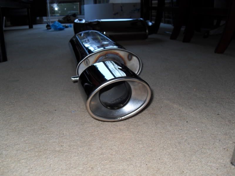

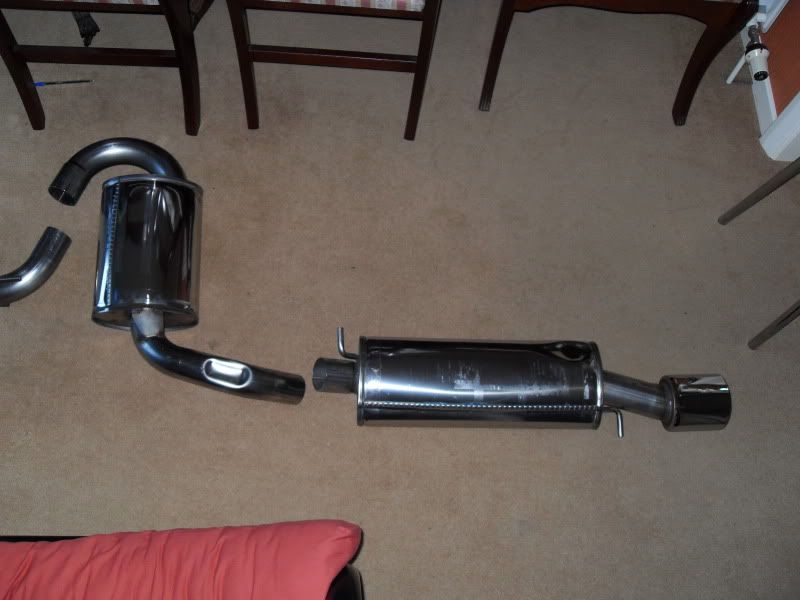

KipVR 1 Posted August 24, 2009 i'd be very interested to see some photos of said Jetex system on the verge of ordering an exhaust Magnex on the left, Jetex on the right. Both are well made, but the Magnex has the edge. Little things like the hangers have a end stop to prevent the rubber sliding off, and the silencer seams are welded rather than crimped- although I'm not sure that is necessarily better.. The Magnex is a smaller bore, and has a more restrictive flow path by the looks of it, although the Jetex does have a nasty dimple where it goes over the rear beam. Quote Share this post Link to post Share on other sites

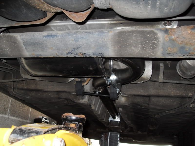

Emkayvr6 0 Posted August 30, 2009 Finally sorted the pics off my other comp so here ya go :) Not the best pic of it fitted but will try and gets some shots next time im down at my mates and can put it up on their ramp cheers Mart Quote Share this post Link to post Share on other sites

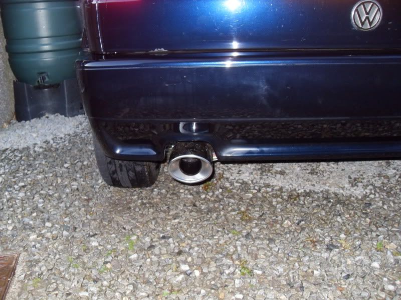

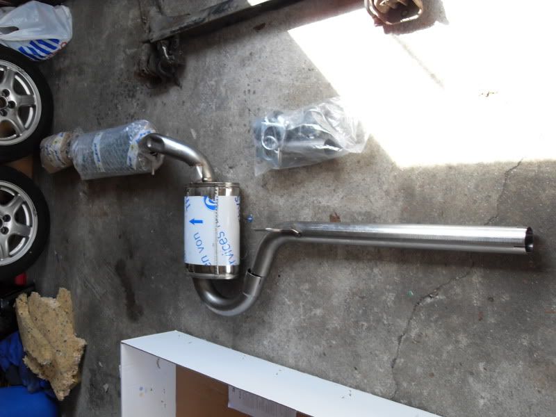

C.P 0 Posted November 6, 2009 Righto, got my scorpion system fitted, end result: nice fit, no rattles etc. but a bit loud under throttle. needed to remove 1 of the middle silencer hangers from the underside of the car and rotate the other one 90 degrees, and had to rotate the rear hanger at the tailpipe 180 degrees. Also had to bend it up a bit to get the tailpipe to sit snugly in the recess. I feel that the tailpipe is a slightly too wide giving it the boy racer look, might cut it off and weld on a new one at a later date, it also sticks out a bit too far from the bumper. Overall I'm happy as it will last forever and since I bought it 2nd hand it cost me peanuts. But i might check out how easy it is to open the silencers and stick more baffles in to quieten it down a bit more. It's not LOUD but definitely not quiet, fine at cruising speed. Quote Share this post Link to post Share on other sites
