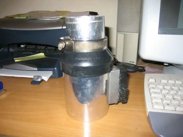

corradovr6sc 0 Posted October 26, 2005 I still think this is the way forward when using the OE management.....a 4" MAF housing. Or a MAP sensor, but I couldn't one of those to work on the OE ECU :( Quote Share this post Link to post Share on other sites
