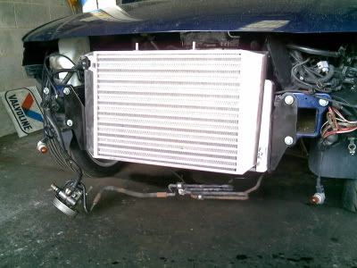

CorradoVR6-Turbo 0 Posted August 11, 2006 I'm going to leave the ISV in place for now but blanked off until i can get down to Vince and see what he can do,if no joy i will delete it. Here is the state of play with mine,lots of chopping and hacking ect....but its looking and fitting well. Just a bit peed off as my hoses for the pipework ore delayed as im wanting black ! Quote Share this post Link to post Share on other sites

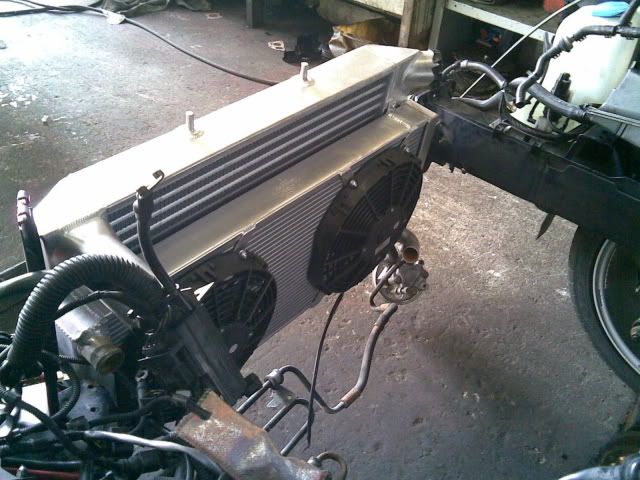

OSV 0 Posted August 21, 2006 Kev a friend of mine is building a turbo engine with approx 450 bhp with plans for twin turbos and 500 plus. There is a thread on Edition 38. http://www.edition38.com/forums/index.p ... hl=dan-ish I was looking at his intercooler and radiator with slim fan set up and was very impressed, IIRC he was of the opinion it would go on a Corrado without much trouble, would this work for you? Quote Share this post Link to post Share on other sites
StormchargedVR6 0 Posted August 22, 2006 This is what RAD-TEC do, sure they could do one for a corrado, this is for a Golf G60 Quote Share this post Link to post Share on other sites
CorradoVR6-Turbo 0 Posted August 22, 2006 Radostormvr6 said: The amount of charged VRs on here you could go for a GB on these. and im almost finished my install !!! :lol: Fitting a FMIC is by no means a walk in the park but neither is getting a cooler and rad made up to suit. You will still need to modify allot to get the pipes to where you want to go and having a custom cooler is good but is just as time consuming. Im adding pictures as i go along to give people an idea what to do and improve on it,everything I've done is on a very tight budget so can be done by anyone. :wink: and might not seem so daunting after reading this thread :lol: Here is a few more pictures.. Quote Share this post Link to post Share on other sites

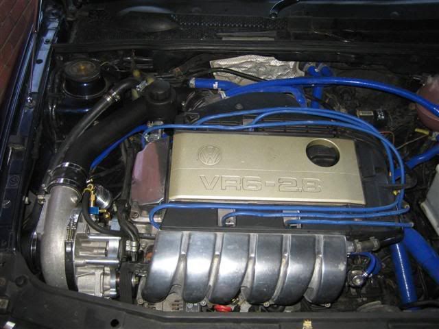

antera309 0 Posted September 11, 2006 Thanks once again for all your help. Here's a pic of the completed install: Quote Share this post Link to post Share on other sites
