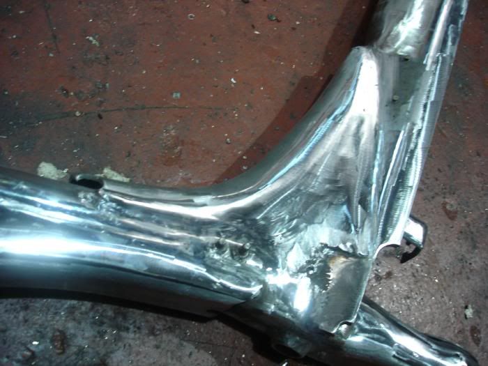

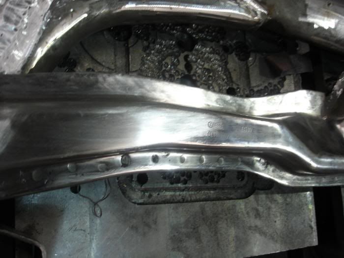

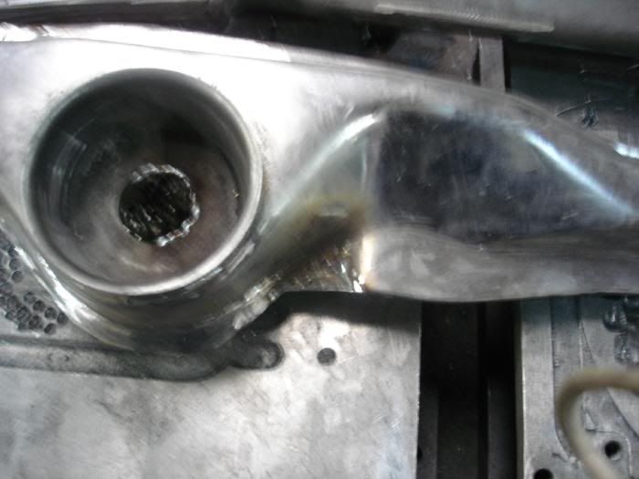

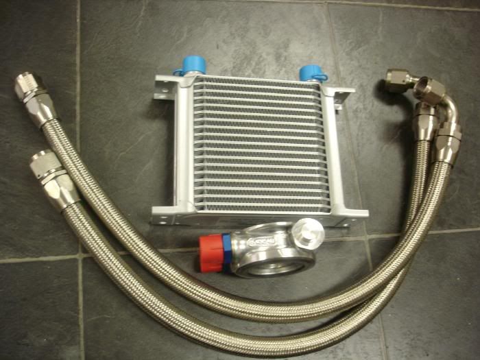

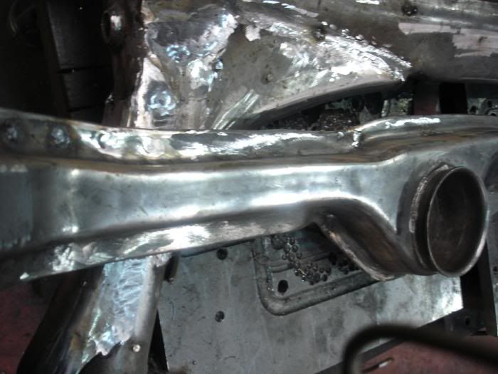

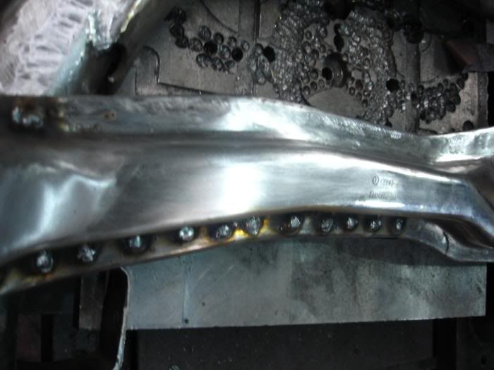

A20 LEE 0 Posted April 9, 2006 Bit of a progress report, rear beam is take ages hoped to post up finished pics by now but i'm still welding and grinding, spotting little pits, welding them up and grinding again. Really hope the finished item is worth the effort. Between this and the subframe the gearbox was easy. Here's a pic, you can see how the various parts of the beam are now starting to blend together to form a clean solid like part and the finish is starting to come through. Here the custom Mocal Oil Cooler, i've polished up the sandwish plate which makes it look like a much better quality part. They look nasty in the cast factory finish. Plan is to make two plates to cover the openings the have a bash at chroming it. My chromers refused to chrome the front cross member due to solution entrapment so i had to drill a couple of extra holes in it. Also took the oppertunity to improve it more by smoothing out the spot welds. Pic below show one side already welded and smoothed. Here's the other side in progress. The welds are then ground back and next the two sides will be hand sanded until they are smooth then polished and off for chroming. Also seam welded the cup for the front engine mount and to the side of it i'll welded in a whole section (where the spot welds were) so the shape of the cross member is more uniform. So a lot to do still as i'm not cutting any corners and having a good think about every piece of the car as i work on it and how it can be improved. Doubt alot of people will spot half the mods but they all add to the finish even if you can't put you finger on whats changed. Quote Share this post Link to post Share on other sites

PhatVR6 0 Posted April 9, 2006 nice to see you're actually putting a lot of work into properly "finishing" the items off and giving that hand made attention to detail, rather than the mass producted "rough pressed" stuff we get from the factory. It will be noticed, that cross member is looking as smooth as silk already. don't chrome the oil cooler. it will probably affect it's effiency. Quote Share this post Link to post Share on other sites

A20 LEE 0 Posted April 10, 2006 nice to see you're actually putting a lot of work into properly "finishing" the items off and giving that hand made attention to detail, rather than the mass producted "rough pressed" stuff we get from the factory. It will be noticed, that cross member is looking as smooth as silk already. don't chrome the oil cooler. it will probably affect it's effiency. Thats whats surprised me the most, just how bad some of the factory parts are and how much extra strength can be added. Highly recommend any one refurbing a car to seam weld subframe. The areas where the wishbones mount are shocking. Not going to chrome the oil cooler, just the sandwich plate. Still bit more sanding to do on the front cross member but its getting there now. The new metal is blending in nicely. Just hard going trying to get out all the pic holes. Think is probably impossible with weld. Decided to have a couple of days off sanding and painted inside the subframe with hammeright black gloss spray. Constrast between the black gloss and chrome looks really good. Well chuffed. Quote Share this post Link to post Share on other sites
