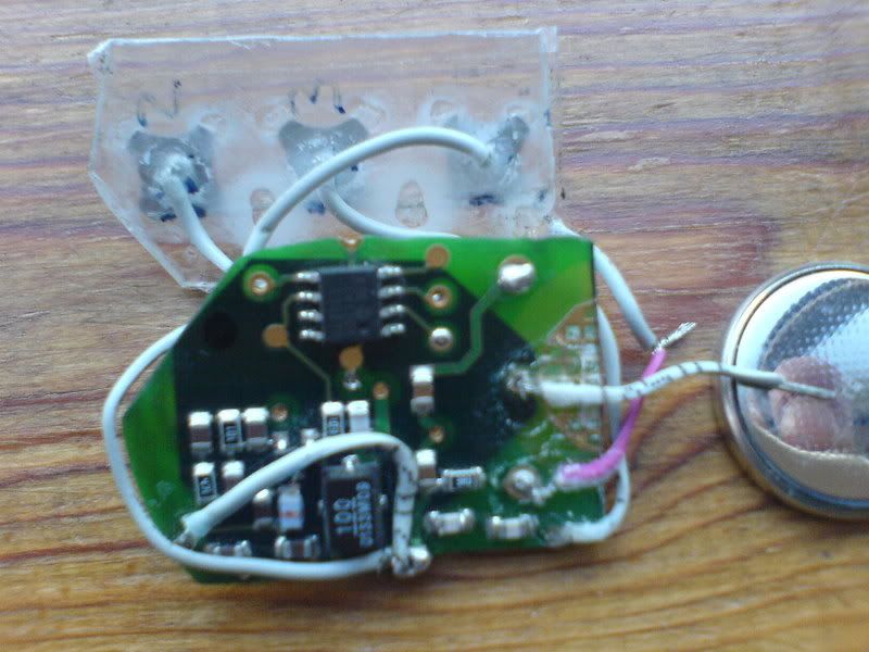

g60ff 0 Posted October 1, 2006 Hi guys, been following this thread for a while and working on my own solution and today have managed to get it finished! Got a clifford on the C and bought a three button flip key off ebay a couple of months ago, did the key part but didn't want to carry around the flip key and the clifford remote so bought a three button clifford remote (ebay again) and got to work with the dremel! Amoungst all the other projects on the go with the rado its taken a while but as it was pi**ing it down today thought i'd try and get it finished. It's taken quite a bit of hacking, gluing and soldering, but it does fit and works very well, fitted remote boot release last weekend and it works with that, just need to test it for reliability. Got a couple of pics of work in progress and will try and take a video tomorrow (just got to work out how to post pics, sorry first post!) Quote Share this post Link to post Share on other sites

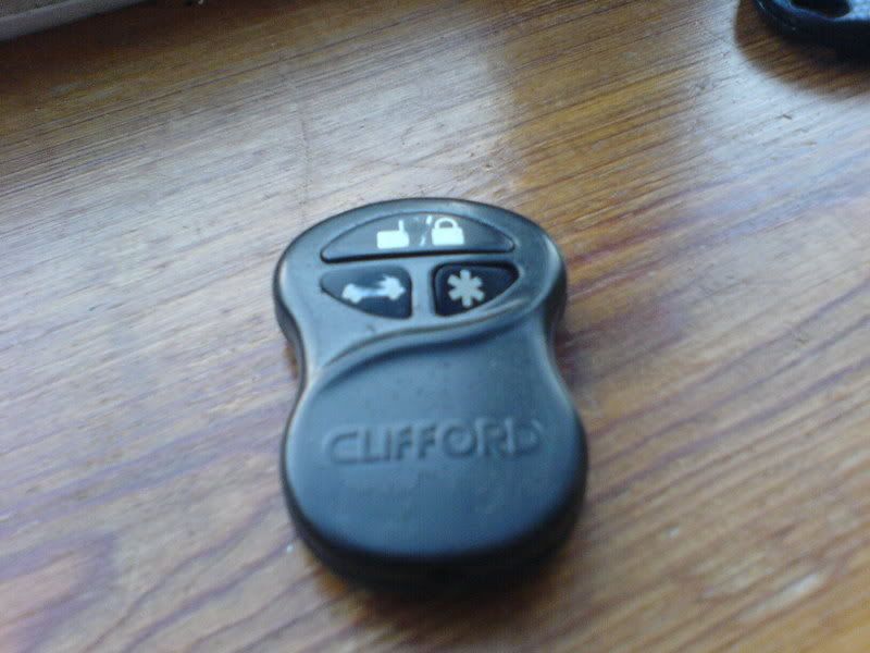

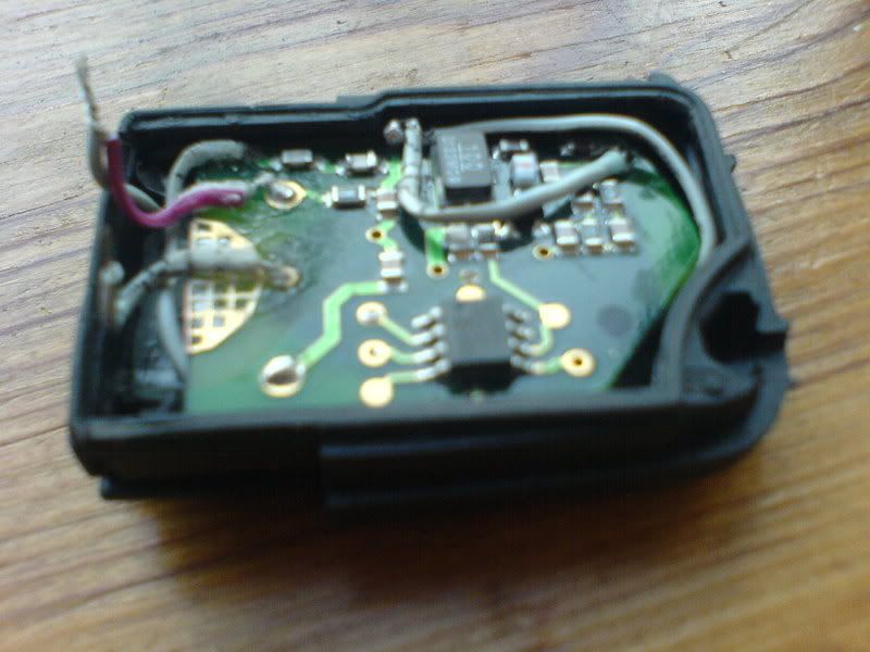

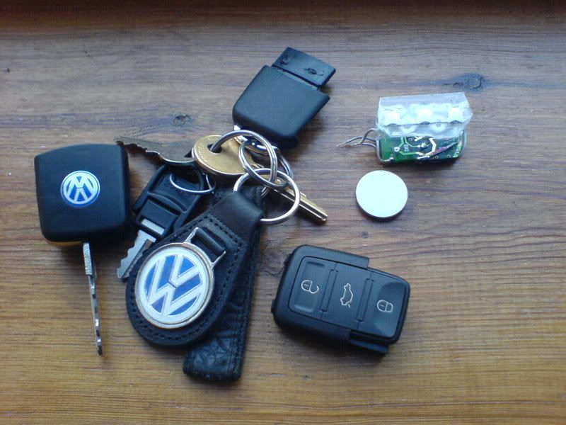

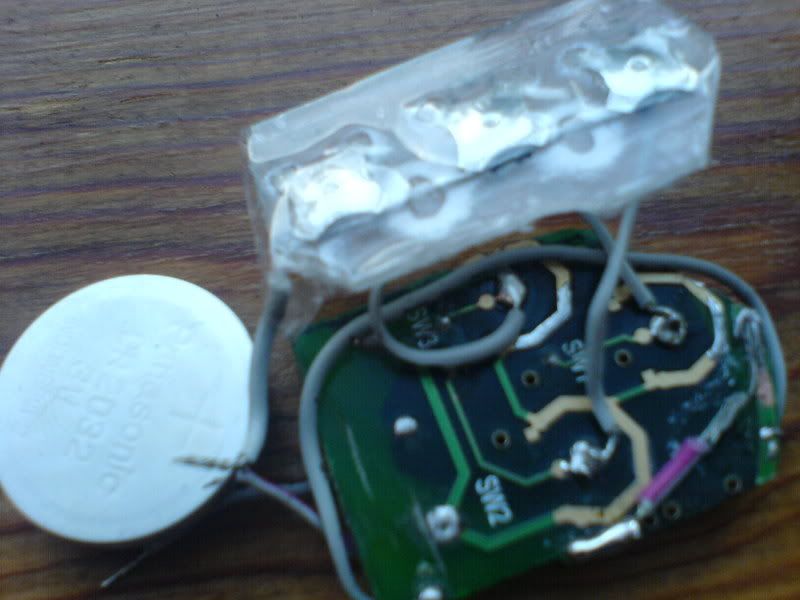

g60ff 0 Posted October 2, 2006 Yeh my key looks the same as yours (3 button?). My Clifford is a concept 300 comes with the carbon effect 4 button remotes but the old style 3 button remotes still work. Took some more pictures today, video will have to wait, kind of broke it dismantling it to take the pictures!! :oops: Quote Share this post Link to post Share on other sites
Guest Posted October 5, 2006 yeah sorry, just realised I didn't actually show the buttons on that pic :lol: looks identical. sorry to here about the accident, I was gonna strip mine down to take pics, but thought i'd break it too ;) looks like i'm in the market for a new clifford then :) oh, when you say the alarm came with a 4 button fob, but 3 button ones work, what do you lose, and presumably any 3 button inards can be reprogrammed to a new (4 button) clifford? Quote Share this post Link to post Share on other sites
g60ff 0 Posted October 5, 2006 Think it's just some of my dodgy soldering, works if i hold all the wires together, don't fancy having to do that everytime I want to get into the car tho :lol: Have you got a clifford/alarm at the moment? My clifford is a G4 (Generation 4?) alarm, there are at least 3 different styles of remote that can be programmed to work with it, not sure which models come with which remotes though. You don't really lose anything as such as you can program combinations of buttons to do different things and there are more combinations on the four buttons than functions on the alarm! The only button that isn't present on the three button remotes is remote headlights. Any of these will work with a G4: [align=center] [/align] Quote Share this post Link to post Share on other sites

coolrado 0 Posted May 25, 2007 i used the internals from my microscan remote (same as autowatch but with boot release) and fitted them into the vw flip key housing, i then removed all of the tracks from the vw remote board and linked the connections from the buttons across to the microscan fob, as the microscan is only a single button to arm and disarm i just linked the lock and unlock buttons on the vw remote together so they both work as arm and disarm and then linked the boot release to the second button on the microscan remote which pops the boot by pressing it twice, its been working absolutely fine for 6 months now. Quote Share this post Link to post Share on other sites
